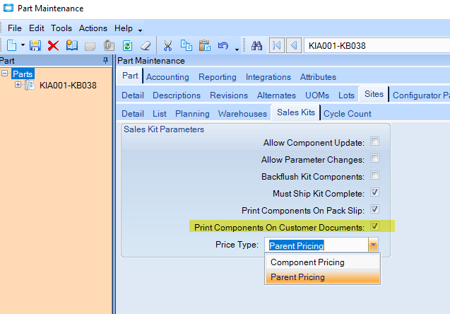

How do you have the kit setup on Part maintenance? We use parent pricing per below, and we like to see the components so have “print components” checked
When we invoice customer gets charged price of parent part and not individual components. Cost of component parts goes into the parent cost rolled and get accounted that way.

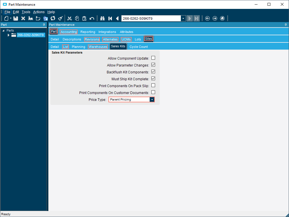

Maybe show screenshot of your part maintenance setup and what your invoice details / edit list look like?

I unchecked print components and tested through and have same result as you. I get the kit components on the invoice details at $0, as you show above. The accounting looks good however. The component costs go to stk-kit transactions and then the kit rolled cost goes out the door in Kit-Cus transaction.
Note, The standard SSRS report also prints the components despite uncheck on print components. Apparently I suppressed them on our Crystal custom report some years back… so we are not getting them on there.

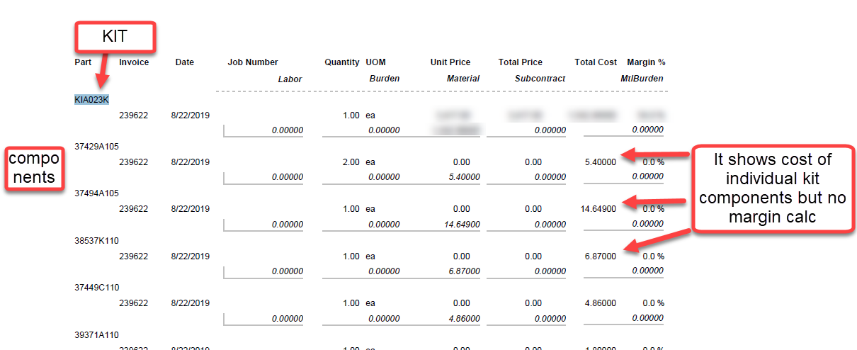

We are suppressing the invoice detail lines for kit components on the crystal report only.
I’m not really sure what report you mean by “margin report”. Assuming you mean the “Sales Gross Margin” report, yes we do see the costs of the individual components on the SSRS report. However, they are not used in the margin calculation on the KIT parent line in the report nor are they used in the margin calculation on the invoice. Frankly, it seems useful to me to show the individual component system costs so that I can see if my current KIT standard cost looks reasonable…
