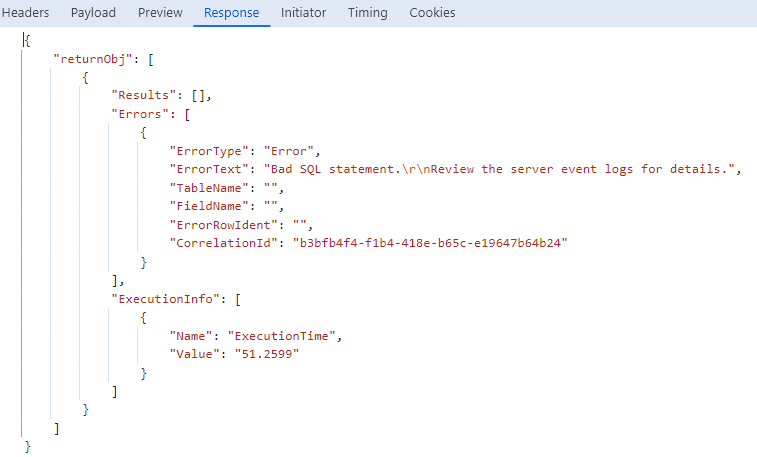

I have created a new slider and added a couple of controls and a panel-card-grid.
Following the Application Studio guide and Hannah’s guide, I got it all wired up, and it seems pretty straightforward.
The odd thing is when I run my UBAQ in the BAQ designer it runs/updates just fine, but when my event runs and hits the erp-baq the payload looks correct, but the response is showing “Bad SQL Statement” (with no further details except a correlation id).
I made sure all the required and key fields specified in the Update Processing part of the UBAQ are both in my related view and the columns in the grid model of the grid

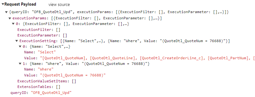

This is what my Network payload and response look like:
The actual where clause in the erp-baq/get/baq execute options is:
QuoteHed_QuoteNum = ??{TransView.OrderLineQuoteNum}
Removing the where clause results in the same behavior so I don’t believe that is the issue
Any ideas appreciated

I’m hoping support can get me more info from the server logs about the error with the correlation id, that’s my only option if I’m cloud-Saas, correct ?
Open up server file download, choose the admin folder, and see if the server logs (appserverlogs) are listed.
If they are, open the latest one (most likely), and download that.
Should be able to find it in there.
If they aren’t there, probably have to contact cloud services to turn them on.

Found it…Got access to server logs :slight_smile:
Stupid typo on one of my columns QuoteHed.QuoteNum instead of QuoteHed_QuoteNum
