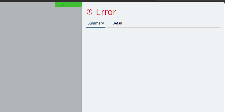

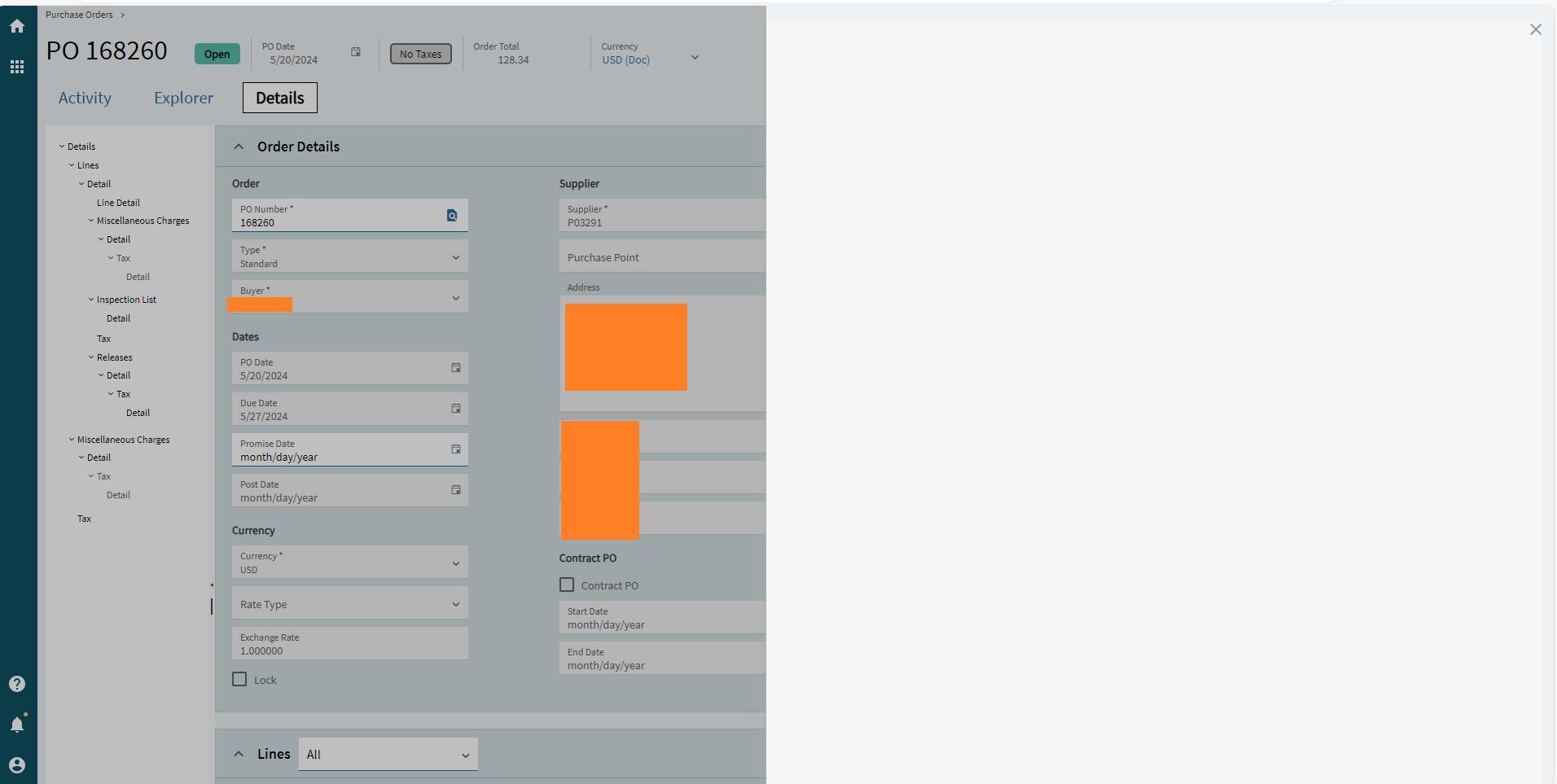

You open a screen/app in the browser and get a blank error, or the window itself is completely blank
Pic of blank error (click arrow to expand)
Pic of blank screen (click arrow to expand)
Here, the user was trying to print the PO; the blank slider panel is what appears when clicking the Print button

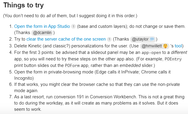

Things to try
(You don’t need to do all of them, but I suggest doing it in this order.)
  1. Ctrl+Alt+I (ask the user to do this).
  2. Open the form in App Studio (base and custom layers); do not change or save them. (Thanks @dcamlin)
  3. Try to clear the server cache of the one screen (Thanks @utaylor)
  4. Delete Kinetic (and classic?) personalizations for the user. (Use @hmwillett 's tool)
  5. For the first 3 points: be advised that a slideout panel may be an app-open to a different app, so you will need to try these steps on the other app also. (For example, POEntry print button slides out the POForm app, rather than an embedded slider.)
    a. Also not a bad idea to have the user log out and back in after any of these.
  6. Republish the layer being used (if applicable).
    a. Also, click that link for advice on testing a base layer.
  7. Open the form in private-browsing mode (Edge calls it InPrivate; Chrome calls it Incognito)
  8. If that works, you might clear the browser cache so that they can use the non-private mode again.
  9. Hard browser reset (@josephp)
  10. Multiple layers can cause a conflict. (@aosemwengie1)
  11. As a last resort, run conversion 191 in Conversion Workbench. This is not a great thing to do during the workday, as it will create as many problems as it solves. But it does seem to work.
Personally, I try desperately to avoid the last option (conversion 191).

Are you 100% sure youve removed the personalisation from xxxdef table. Is the slideout a built in slideout or is it calling an application
Good clarification. I’ll add that… somewhere. Maybe a footnote.

I did add it - it’s #4 - until I rearrange again.
