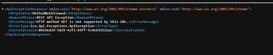

Looks like it’s trying to execute the BAQ. When I click on that here is what I see.
Figured it out. Originally, I had two fields with the FilterOnNull checked. When I looked in Developer tools I saw that it was feeding a null parameter into the Where clause.
Example " Where OrderDtl.PartNum LIKE N’NULL%’ "
That line alone eliminated any chance data being returned unless there was a new PO with only the header saved. I removed the FilterOnNull and it started working fine.
