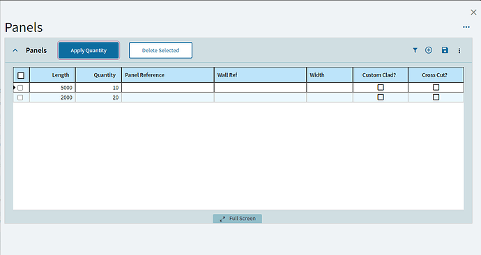

We have this custom dashboard which slides out on a button click on quotes and orders…
its attached to a UBAQ and functionally it works perfectly and as it should! (not bad for Epicor :wink: )
however to add a new line to this list, we have to click the + icon in the top every time, and some times there can be anywhere from 1 to 100 lines of data to enter into this grid.
is there any way to simply press the enter button like you can in classic to make the data entry less painful?

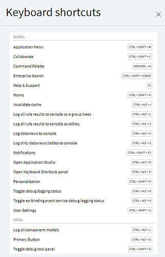

Press CTRL+ALT+H to bring up the shortcuts menu.
You can click Edit and change the shortcut for Add New to be Enter (probably). I didn’t actually test this.
no ‘new’ shortcut…
