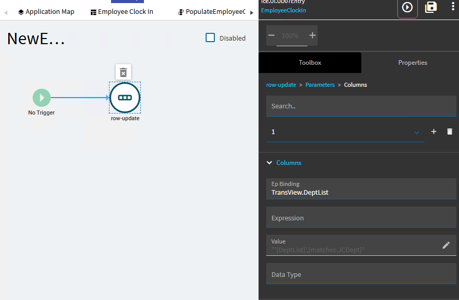

so what I’m doing so far is using a DataView-Condition to create a iteration, and updating a column to assign the value, the thing I don’t know how to do is the expression to concatenate what ever I have stored in the column and add the next iteration value and separated by a comma, I tried stuff like:
“{key1},{matches.key1.value}”
or
“{key1}{if matches.key1.value},{matches.key1.value}{/if}”

I don’t think you can drop the dataview name in the expression - can you?
Try "{TransView.DeptList},'{matches.JCDept}'" to add one item to the existing list … as long as you add the first item a different way … or remember to ignore the leading comma

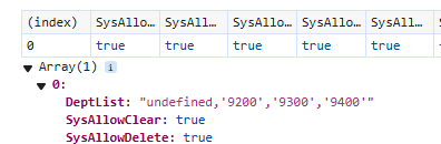

that one works, thanks Jonathan, I got this:
still not sure how to fix the undefined part
