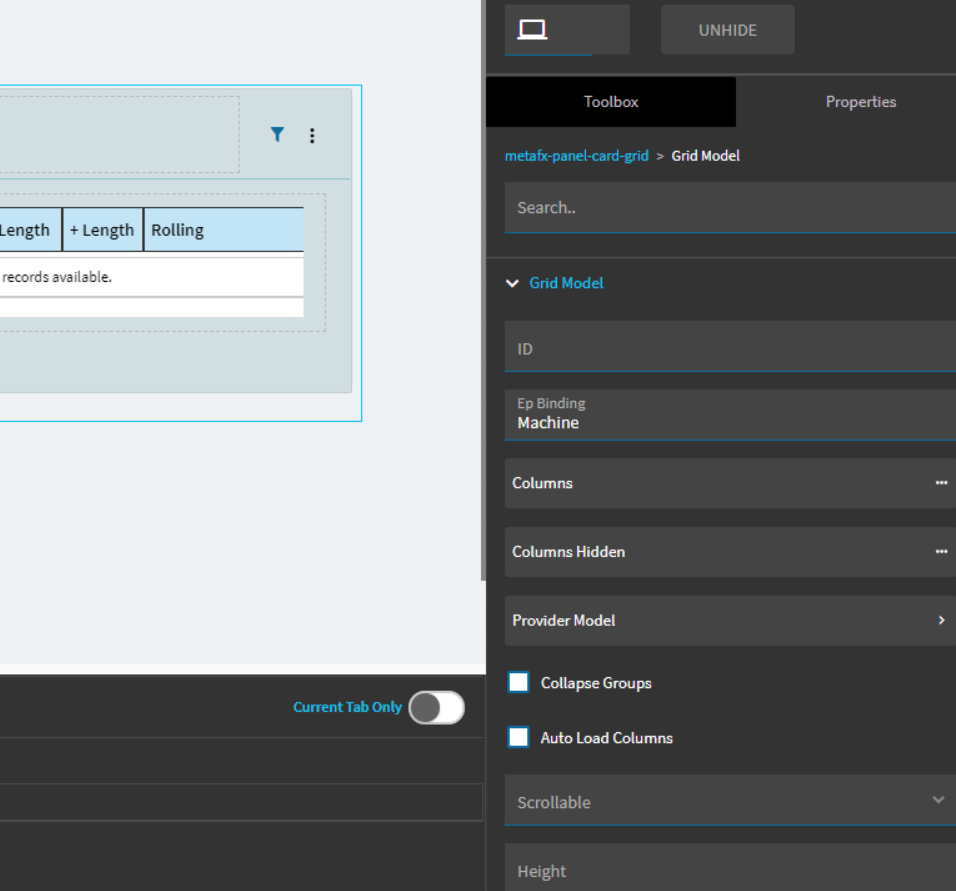

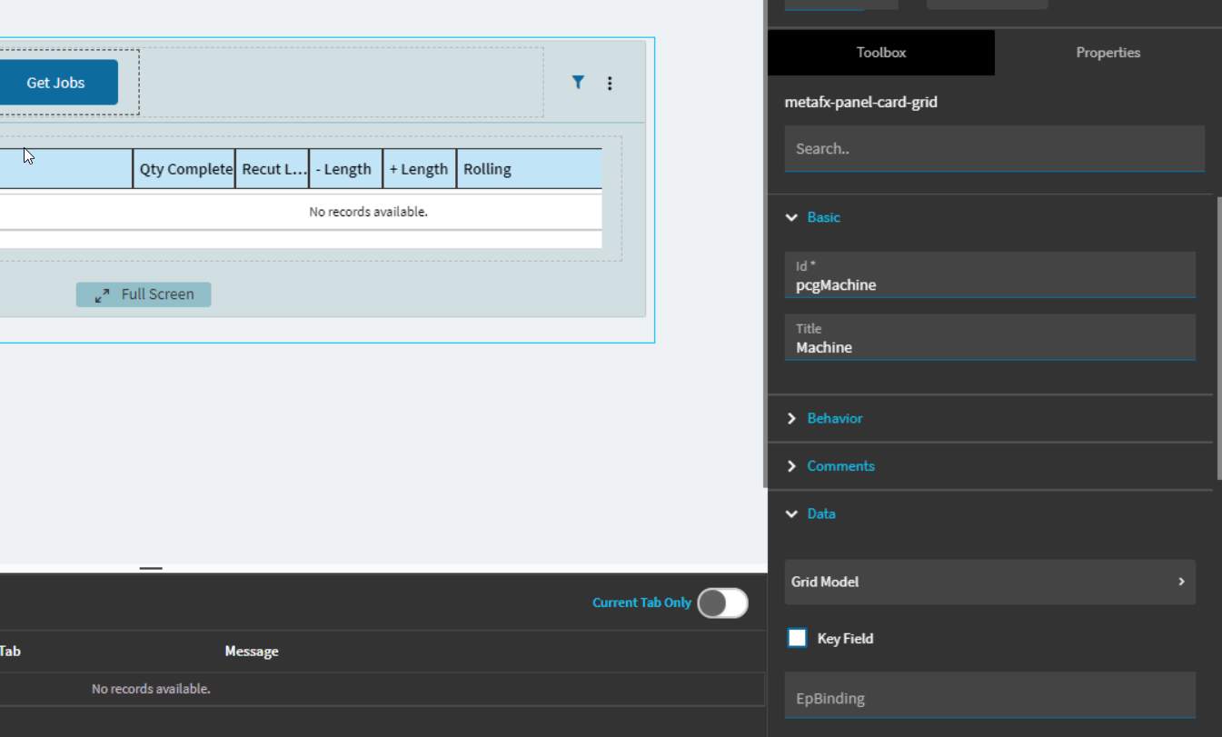

In the grid you will need to go into Data → Grid Model → Columns

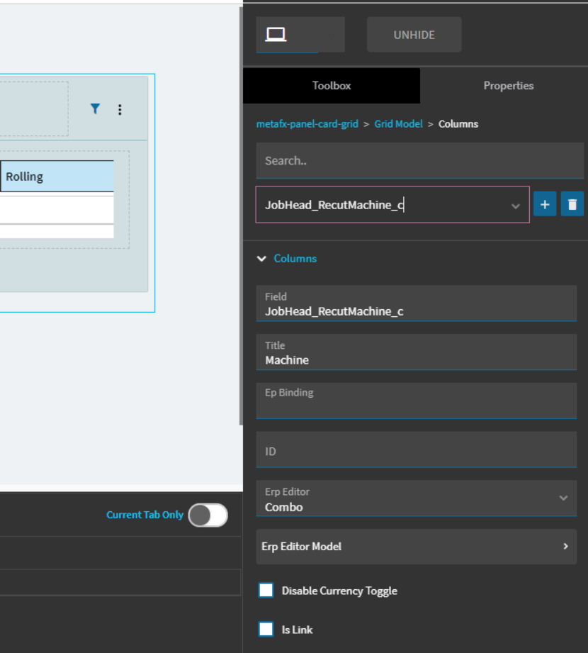

Then select your column and for the ERP Editor Select Column

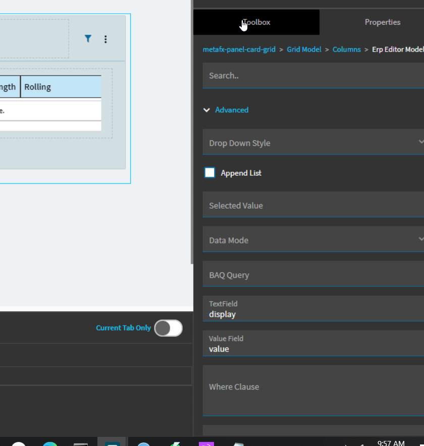

Then in the ERP editor model you will need to select Advanced and set just like you would a normal combo.
