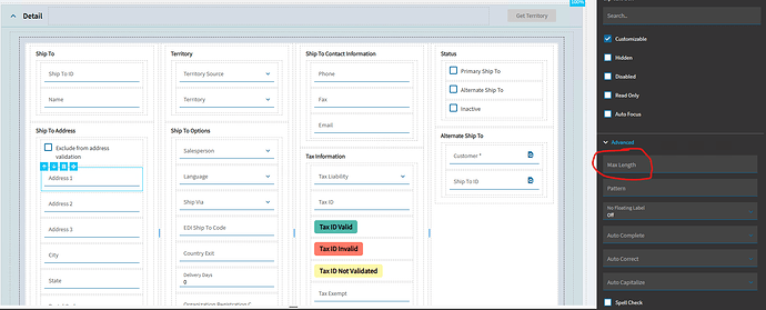

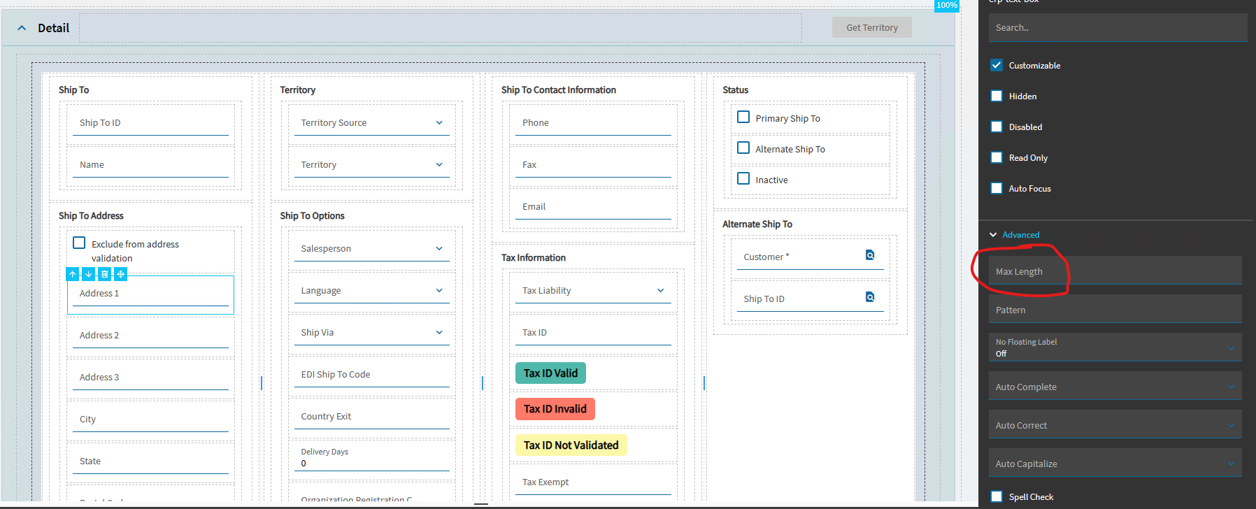

Maybe lean on the framework for some of that work? I have to stop thinking about always using code. I’m with Mark though, I would want to do this at the server to protect the table from DMT runs or a REST integration with a CRM. But I am sympathetic to the immediate feedback idea. Maybe use properties in all the places?
Eureka! I love the simple solution @Mark_Wonsil and apricate the challenge to think out side of the box. Can’t see the tree from the forest as they say!
I will still experiment with the others suggestions to gain more perspective of things, but I’m now looking through a different lens.
Well, a great idea currently does not work. I’ve verified with support that Kinetic is not respecting the Max Length and Epicor has opened a Problem case for it. PRB0277312.
