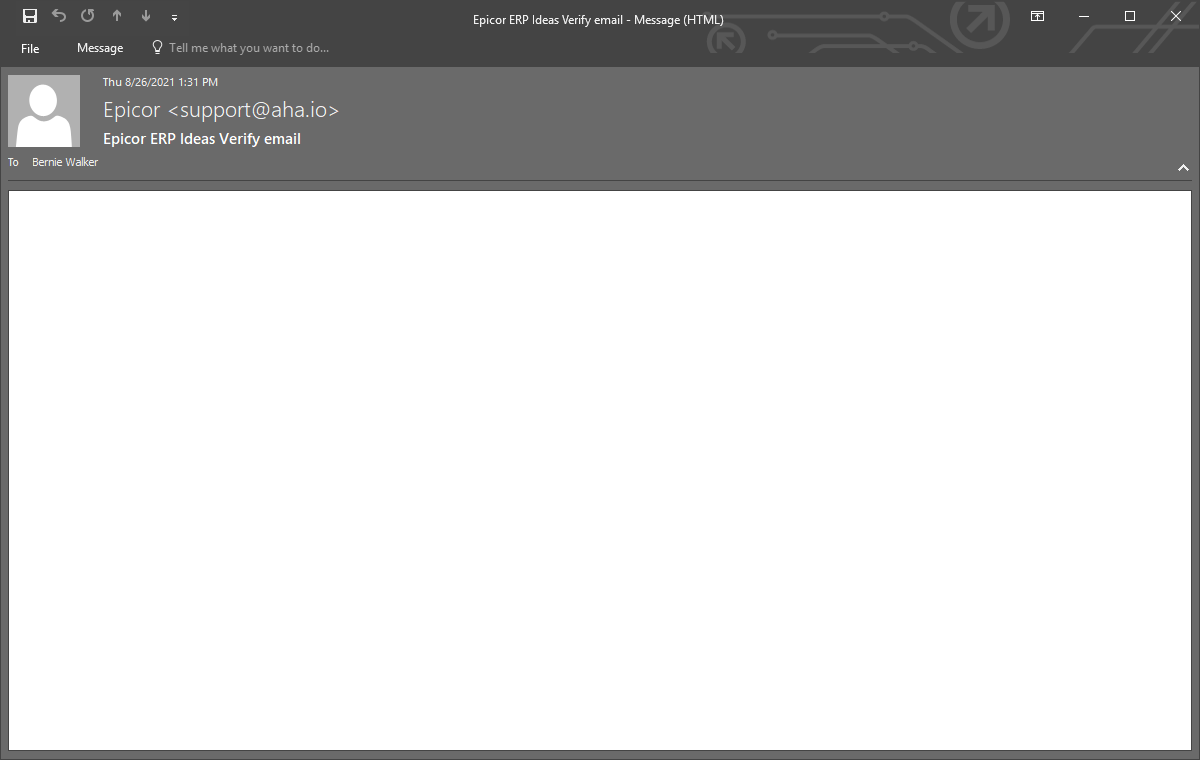

Every time I try to access Epicor Ideas, I get a blank email trying to verify password
