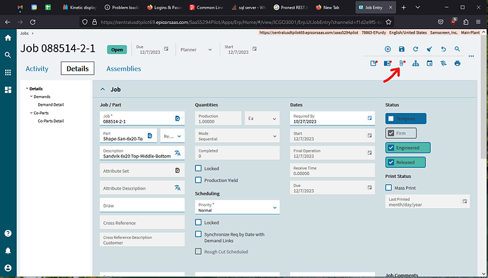

The attachements button is under many different screens, I’m not sure if there is a list anywhere. Jobs, orders, quotes, etc. Example below is job entry:

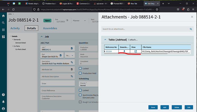

A panel will fly out. It has the file path and buttons to either view or download the file(s).

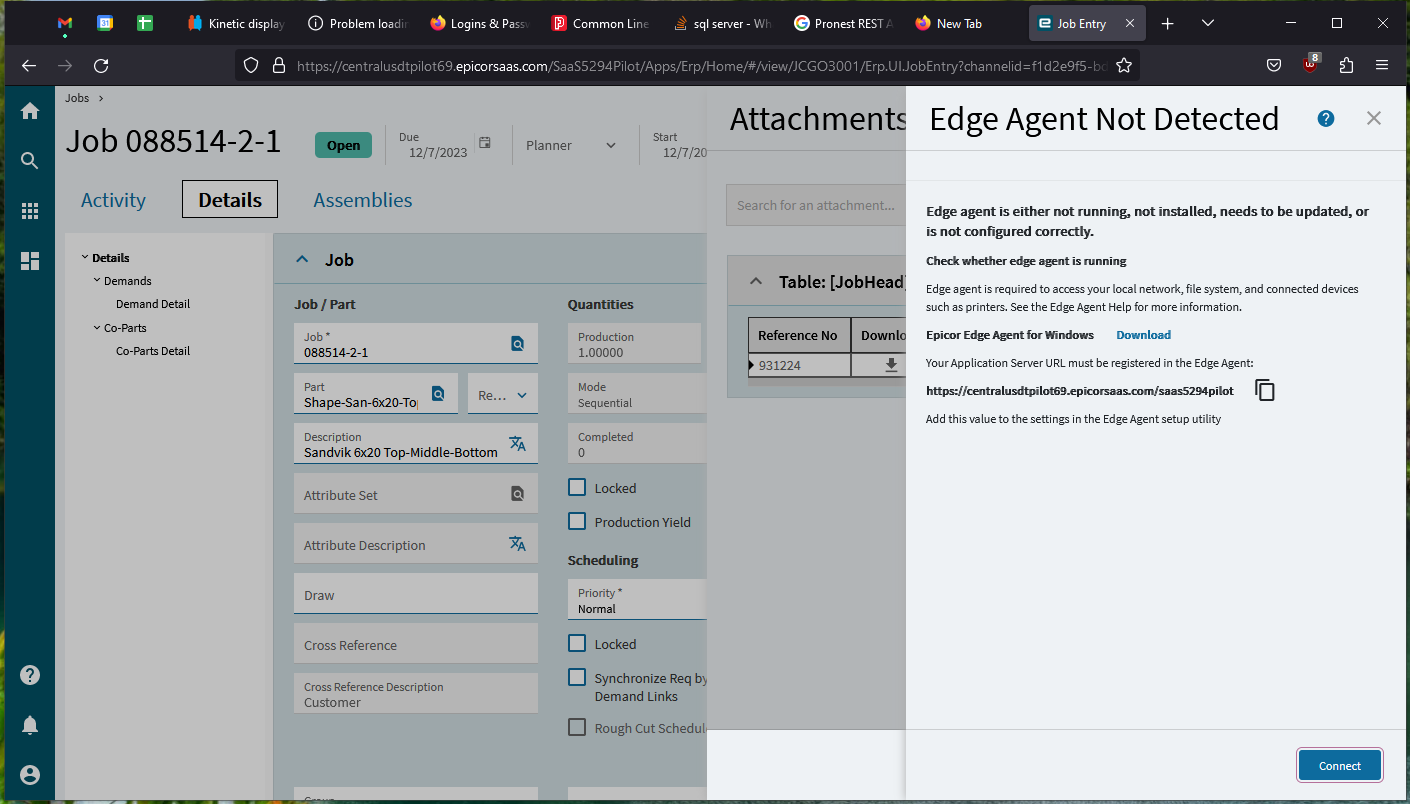

These buttons will not work unless the Agent is installed, as these messages show:
That is what Mark was referring to.

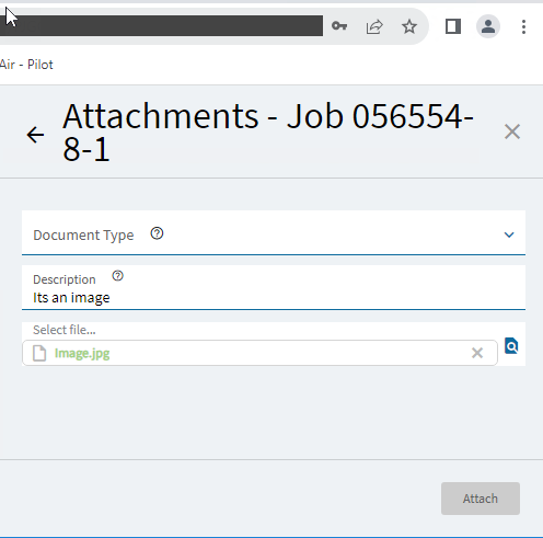

They will both let you add documents manually, we use the mapped drive letter not the UNC path.
But unlike classic when you drag and drop to prepopulate the mapped drive letter and path to the document the application just drops in the document name with no path which is understandable, it’s not a 2 way path yet.

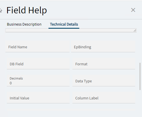

Where does document type DDL get populated from? I apparently have none available to show. And checking the technical details gives me nothing.
System Management/Document Management/Attachment Type Maintenance
