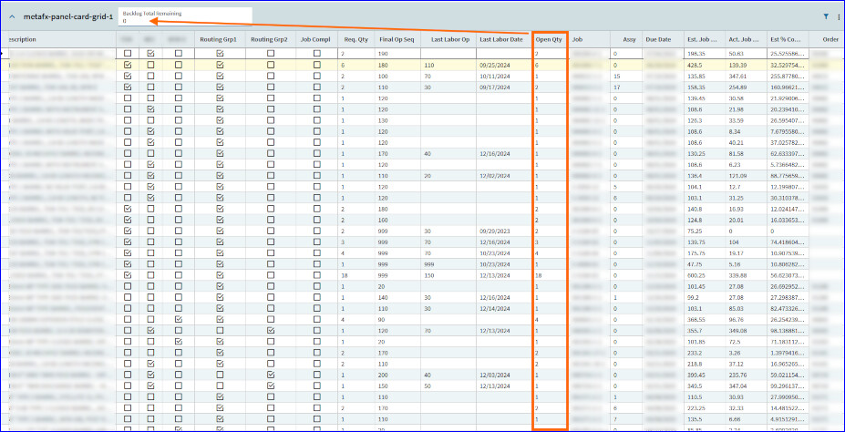

I’m wondering if there’s a way to add a numberbox to use as a pseudo KPI. Basically to quickly provide a sum total of the Open Qty of the particular backlog.
So, my BAQ results come in, the grid populates… I know there are grid filters/summations I can use on the grid itself. But can I use a function to also analyze the BAQ results/dataview (via Kinetic-Function widget) and to spit back a sum value in the actionResults?
I feel like this should work… but, as a code-deficient individual… I’m hoping someone out there may have done this before and could provide a starting point. I can tweak… but coding from scratch is not a part of my bailiwick.

Are you wanting to sum that highlighted column, and put it in that field you pointed to?
Yup

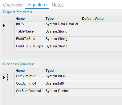

Yes, pretty simple actually. You’ll have to decide how to trigger it, but you just have a function with a DataSet as input, and an output parameter with your sum.
You’ll pass the whole dataview as the input from the UI.
If you can show me the dataview structure, I can pop out a simple function for you, and link a thread for passing a dataview.

The DataView is just called “Backlog”.
The target column, in this instance is: Calculated_RemainingQty

//You can pass "Int64", "Decimal" for FieldToSumType, otherwise it will default to "Int32"
//Chose the "OutSumXXXX" you need.
switch (FieldToSumType.ToLower())
    case "int64":
        OutSumInt64 = InDS.Tables[TableName].AsEnumerable().Sum(x => x.Field<Int64>(FieldToSum));
    break;
    case "decimal":
        OutSumDecimal = InDS.Tables[TableName].AsEnumerable().Sum(x => x.Field<decimal>(FieldToSum));
    break;
    case "int32":
    default: //Int32
        OutSumInt32 = InDS.Tables[TableName].AsEnumerable().Sum(x => x.Field<int>(FieldToSum));
    break;
