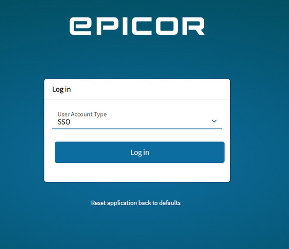

After using Log Out > closing browser > reopen browser > we are now presented with the Epicor Login page rather than being logged in automatically.

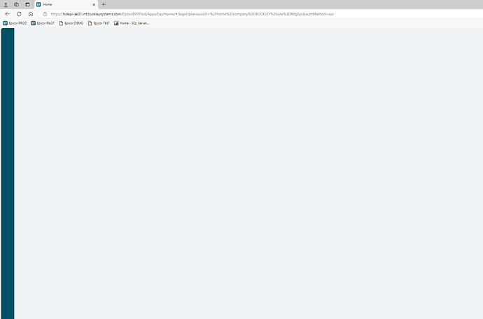

Sometimes this will redirect to Kinetic Homepage after a little while, sometimes you need to click the Login button, sometimes clicking refresh of browser seems to work, sometimes you get a white screen with blank menu bar down the side and after awhile home page will load or clicking refresh works.

  • Directed to Epicor login page (below)
  • Hangs on this page for 40-50 seconds before being directed to Kinetic home page (do not need to click Login or refresh or enter username/password)

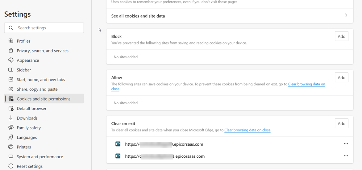

We’ve found putting the URLs to flush the cache on closing the browser has helped with other issues we’ve ran into. Could it help in your login case?
Note: Microsoft in their great wisdom doesn’t have this as a GPO option so it has to be set by other means. At least that’s what our infrastructure team told me. :man_shrugging:
oh interesting! I am going to try that.

This is what keeps happening to me, LITERALLY in the middle of working (0 seconds of inactivity). I just logged in this morning so its not like the token is expiring after 24 hours or whatever (although that would also be unacceptable considering there was no inactivity - it should be getting extended). Nothing but crickets from support for 3 weeks now.
After closing the browser and going through MFA all over again:
