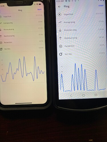

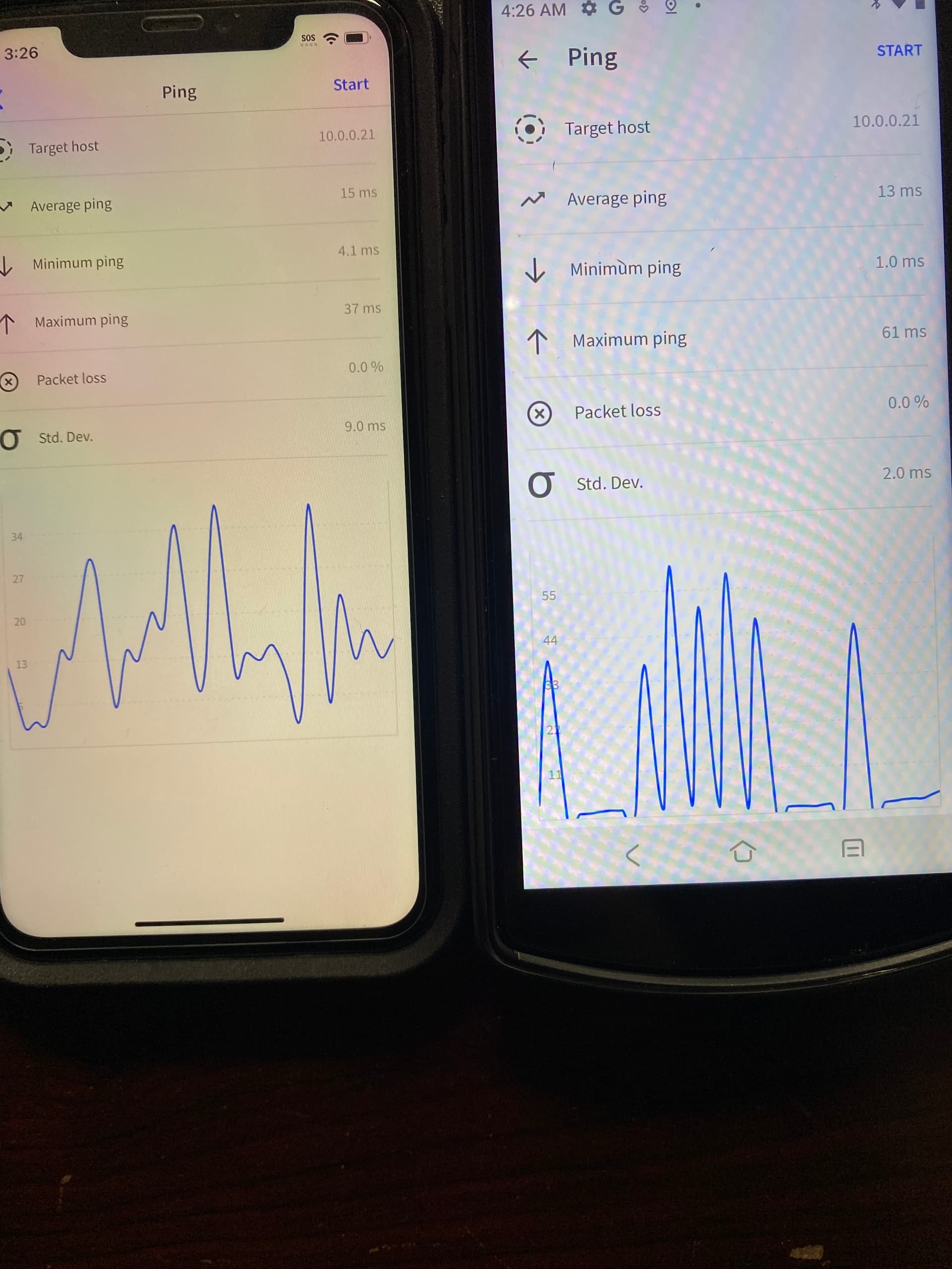

Everything else seems OK on the device. A quick comparison of just simple ping test side by side.
