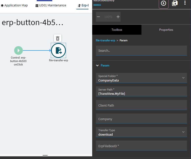

I see in the Application Studio Toolbox there is a component called “file-transfer-erp” that indicates it can take a file from a server folder and send it to the client’s browser’s download folder, that would probably work for my purposes.

Confused, how did the file name get (“shoved”) into TranView.MyFile ?
That would solve half my problem, the other half is how do I create a file on the server ?
