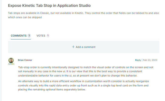

Thanks, Alisa, for digging that up.
I attempted Brian’s “alternate” approach, creating some new text fields in a top level card… but I think the background events take over and focus still shifts automatically. I certainly can’t tab from one to the next in a nice sequential order.
I’ll have to keep testing.
Heres the link if you want to reply to Brian’s comment: Epicor Kinetic Ideas

@dcamlin - Did you try dragging the original controls to the top level card? Does it let you do that?

I did NOT attempt moving native controls to the top positions. I think this would be easy to test, though, and see if tabbing would move from one to the next.
I was hesitant to move the native controls primarily due to Kinetic forms still being in flux and if Epicor changed their layout it would break what I was trying to accomplish.
