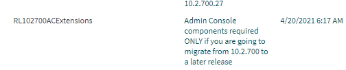

For me after installing the admin console and updates for 2021.2 All Database and Application server snap-ins showed in the admin console except for 10.2.700. My instance of 10.2.700 (now I look at) why 10.2.700.3 so that might be why. After installing the RL102700ACExtensions they then showed. I wasted a lot of time on this one…Being in the latest version of 10.2.700 probably would have resolved this…
So for anyone who is missing the snap-in from the Show Database Server Extensions or the Show Application Server Manager Extensions context menu for 10.2.700 then the RL102700ACExtensions should fix this.
Hopefully someone searching for the above will get a hit. :slight_smile:
