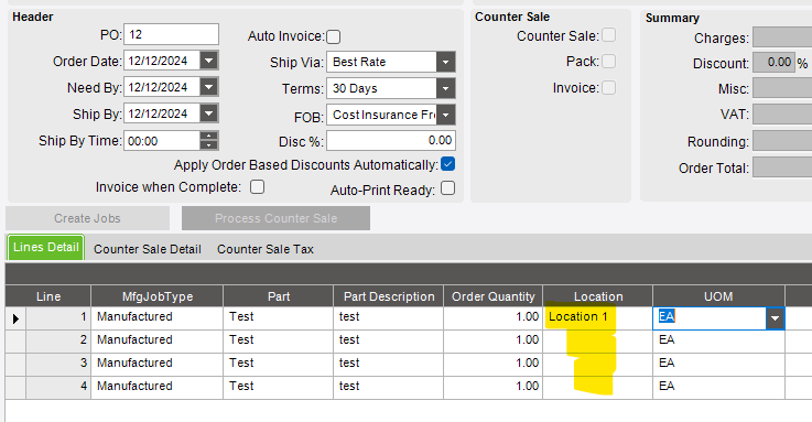

We are beginning the process of re-writing our classic customisations to function within Kinetic. We have encountered difficulties in making UD fields available in the Kinetic interface. Our OrderDtl table has been extended to include a UD field called Location_c. This immediately becomes available to view in the Classic Order Entry screen…
Accessing the Kinetic Screen, the new field is not available.
Personalising the grid allows me to display the column.

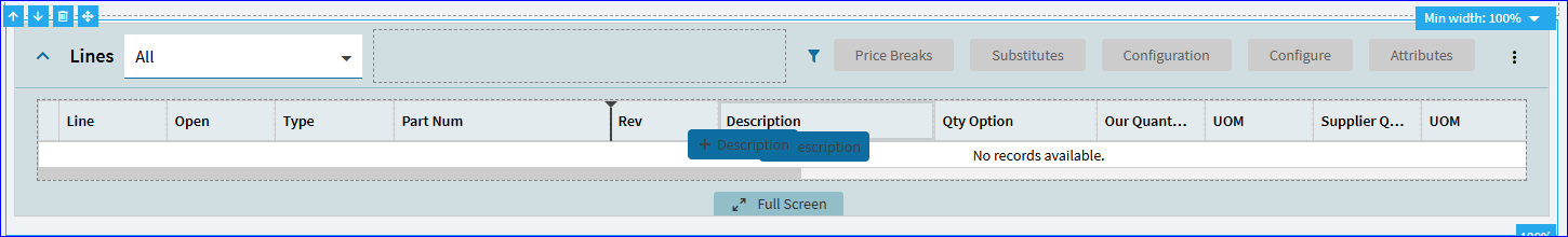

Thank you for the kind welcome. Whilst I have a customisation layer created the grid does not appear to have any function that allows me to add or hide columns.
So, since your image above was PO Entry… I’ll show that…

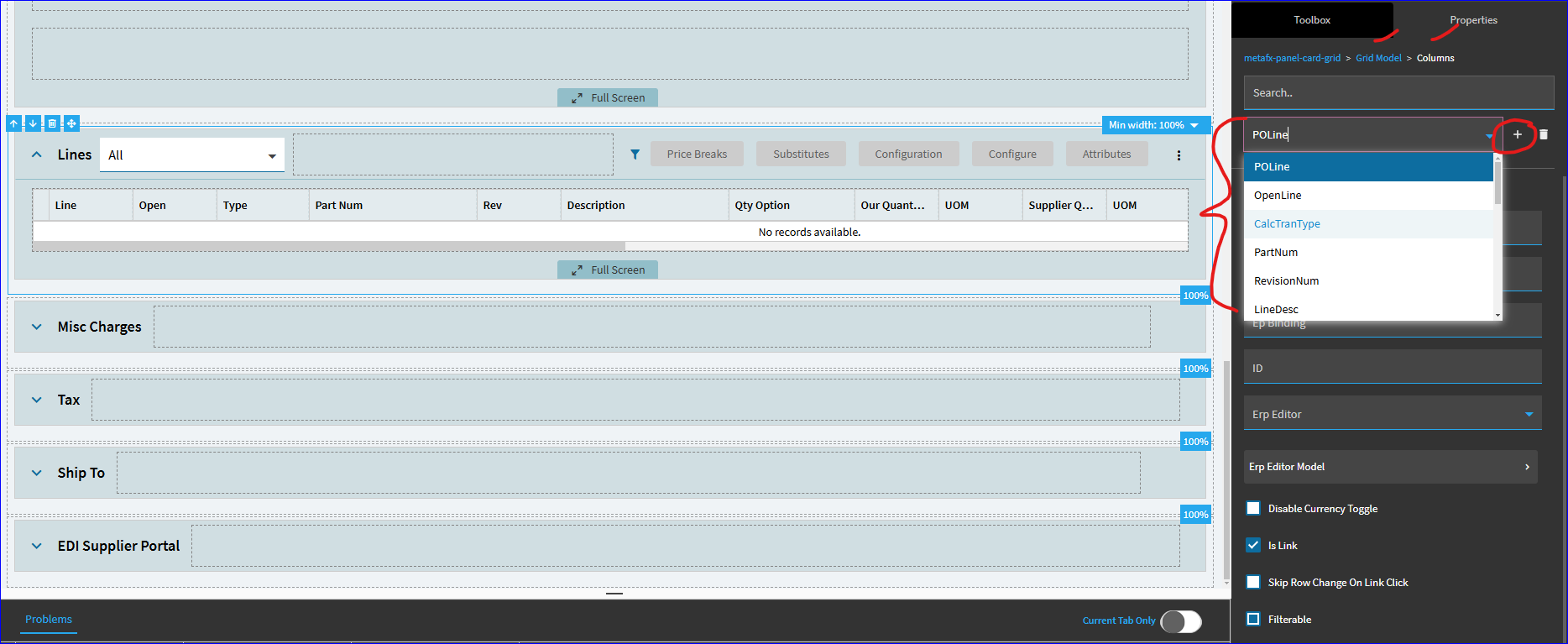

Open up your custom layer in App Studio. Navigate to the page with the grid you’re trying to work with. Click on the grid (to highlight it) and click on properties over on the right side of the screen.
Expand “Data”… then click on “Grid Model”.
Scroll down and you should see another area called “Columns”… open that.
In the “Columns” area, you’ll see a dropdown which should contain all the columns that are currently viewable in the grid:
You’ll want to click the (+) icon to add a new column. You’ll type the Field Name and give it a “Title” (the column heading as you want it to appear).
That’s really all you need to do. Preview the layer and see if it now appears in the grid. If so, you can save & publish your layer. If you haven’t previously applied this custom layer to your menu… you’ll have to do that in Menu Maintenance.

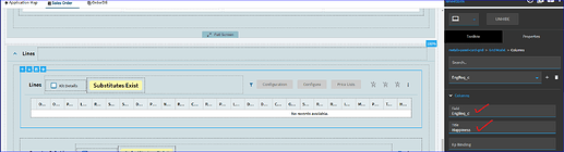

I don’t have any custom field on PODetail… but in the below example (using Sales Order Detail instead)… I added a column to Grid Model > Columns:

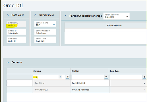

As I mentioned… UD columns should already appear in the DataView:
So I went to the target grid’s Grid Model > Columns and typed in the first one:

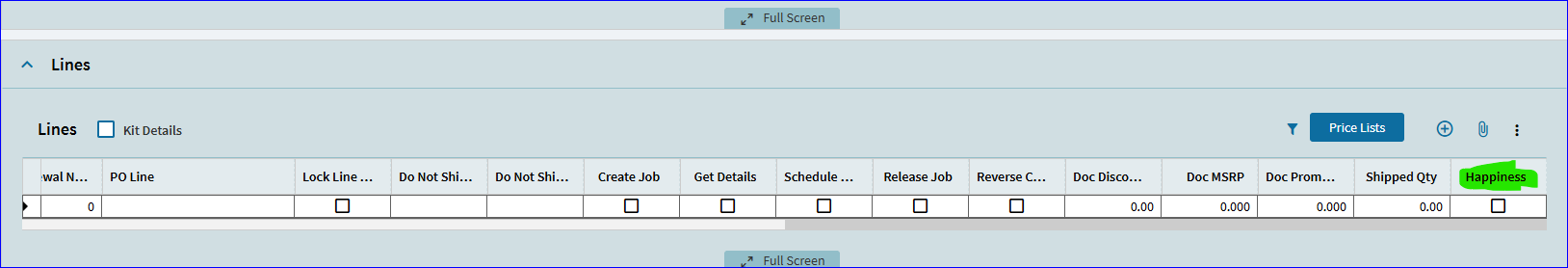

Preview:

If you open the dataview… can you see your UD columns listed if you filter with “_c”?
If so, copy one of the field names… paste it into Grid Model > Columns… you don’t need the entire binding, just the field name.

Location_c SHOULD be included in the OrderDtl dataview… just like my UD columns were included in mine.
Agree, OrderDtl should work the way you showed it.

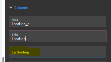

The UD Field Location_c did exist in the dataview. I tracked the issue down to the fact that I was populating the EpBinding data input with the Table and Column name, in this case OrderDtl.Location_c. Clearing this value resolved the issue.
