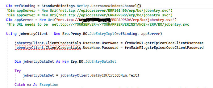

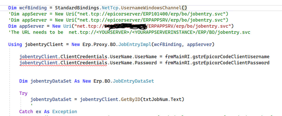

An example of a program not working is below.
This code is working without issue on our 10.2.300 system.

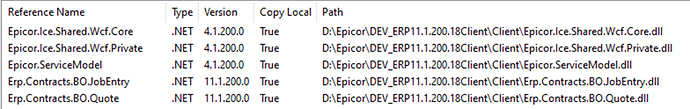

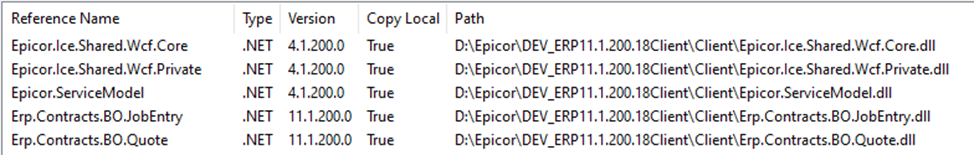

I did add the two Epicor.Ice.Shared.Wcf.x references from suggestions found in this user group and it did eliminate many errors.

Looks like the signature has changed:
Using jobentryClient = New Erp.Proxy.Bo.JobEntryImpl(uri, userId, password, authenticationMode)
AuthenticationMode seems to be Windows, AzureAD, IdentityProvider, Token or Basic.

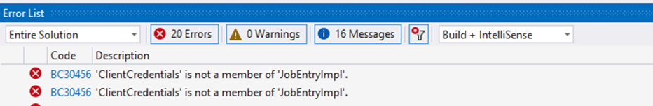

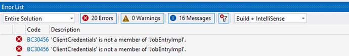

The clientcredentials appear to be readonly.
