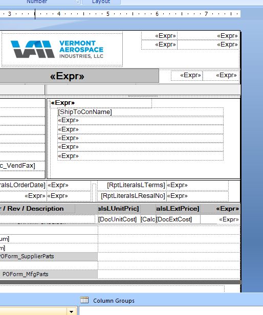

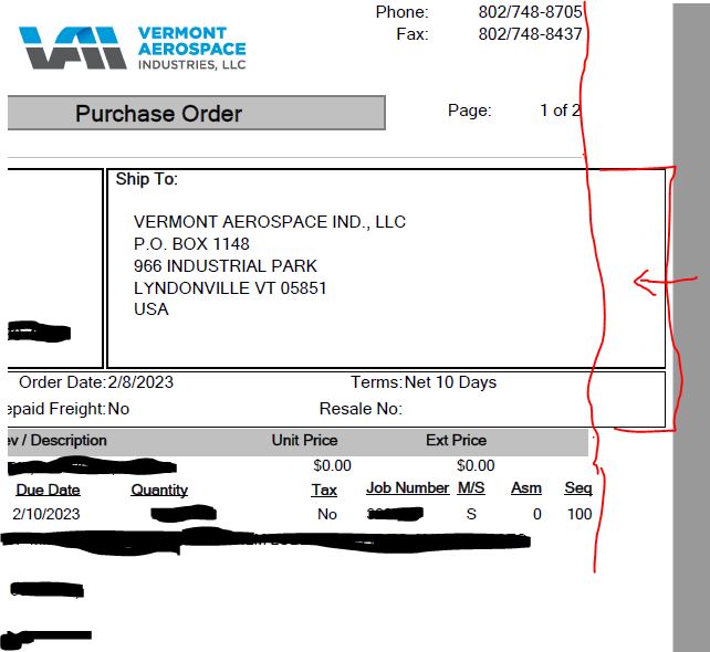

After I made this change, I noticed that the Ship To box is taking up extra space on the right side of the report.
I can’t seem to find any property that shrinks this back down to the same size as the rest of the page.
I have tried changing the report margins, and ConsumeContainerWhitespace.
Any ideas?

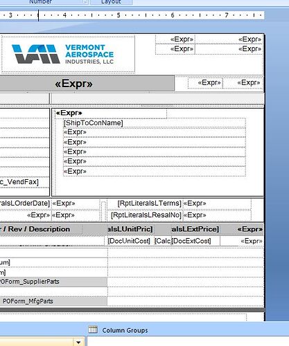

Epicor uses construction boxes to control some sizes - see where I’ve highlighted, that is a tall thin rectangle.
If you make that smaller and check it’s properties, you should be able to make the Shipto smaller overall.
I see the rectangle. I tried shrinking the width and I tried deleting it. Neither seemed to alter the rendered output. Note that in report designer the width looks perfect. It is only in rendered mode that I see the ship to box get stretched. Actually, look back at the original picture. The area with ShipVia and Terms, also get stretched out to the edge of the page. Those are the only elements I see going past the page size. Are there any other likely settings I can try?
Thanks!
That’s because it’s the controls on the right side that you actually made larger, so for example, first select that top-right Expr box and change its size and/or placement if you need so that it’s out of the way and not on the far-right. Then go down the line, modifying the controls that are in the area you want clear. Then you’ll be able to drag the right-side of the page over to the left again - no controls will be impeding it then.
Hope that helps. If not, I could take a little video that explains what you did much clearer. POForm especially is a super fun report - lots of tiny hidden reference boxes everywhere. It’s probably one of those you need to fix to get the page break right, btw. You’ve totally got this! :slight_smile:

I tabbed back and forth to try to find any control with can grow still on. I didn’t find any controls that looked to be a problem. I messed with the page margins. I even shrank some controls inside the tablix, so that I could shrink the right side of the tablix back, but nothing seems to help.
I attached a copy of the report. I don’t think there is anything company related in there, as the data comes from the database. Curious if you see anything that stands out as an issue!

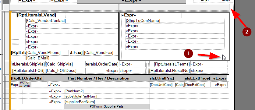

I loaded your RDL and noticed that the tablix looks even narrower than what prints (as shown in post #3). I clicked in the box (#1) and #2 shows the tablix width.
Also, there are two very tiny rows as the first two in that tablix. They seem so have a few textboxes in them. Did you mess with the properties of either those two rows, and/or the textboxes in them?
Yes, I shrank some controls in the tablix, so that I could shrink the right side of it. There are all kinds of tiny rows, hidden text boxes, and rectangles. I didn’t make this report, I just modified it. I don’t know why they are all in there. I assume Epicor built the base report with a bunch of extra spacer textboxes. At this point, I have messed with many of the textboxes, rows, groups, and other controls. :stuck_out_tongue:
I solved this by cutting the shipto rectangle and inserting a new rectangle in that tablix cell, then pasting the shipto rectangle back in. This let me manually change the size of the rectangle container which seems to have done the trick! I also did the same thing for the ShipVia rectangle.
