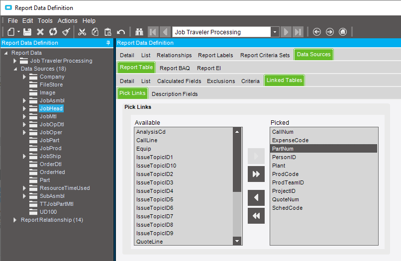

One difference is I have Relation Type in the Report Data Definition set to Output
Not answering your particular question but I find the Linked Tables features much easier than adding a new table. Start with selecting the JobHead table and go to the Lined Tables Tab. Make sure that PartNum is in the Picked panel.
Switch to the Description Fields tab and make sure PartNum is chosen for Pick Fields for this Link. Now just select the fields you want, like Specification.
In your SSRS report, you access the field as PickedFieldName_Field, e.g. PartNum_Specification.
Before adding a table, I will try using a Linked Table first since there are fewer steps to get the job done.
That was the solution to have data in the Part table!
thanks!
