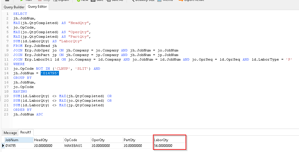

Has anyone else seen an issue where JobOper.QtyComplete is not updating with labor transactions correctly? I’ve not found parts, employees, resources or anything in common between the jobs with issues. I wrote a query to show me the ones out of syn its really strange. Recalling and resubmitting labor records makes no change I’ve only gotten through it by jamming the correct value in through TSQL update and then recalling and resubmitting the labor record after to sync up JobHead.QtyComplete.

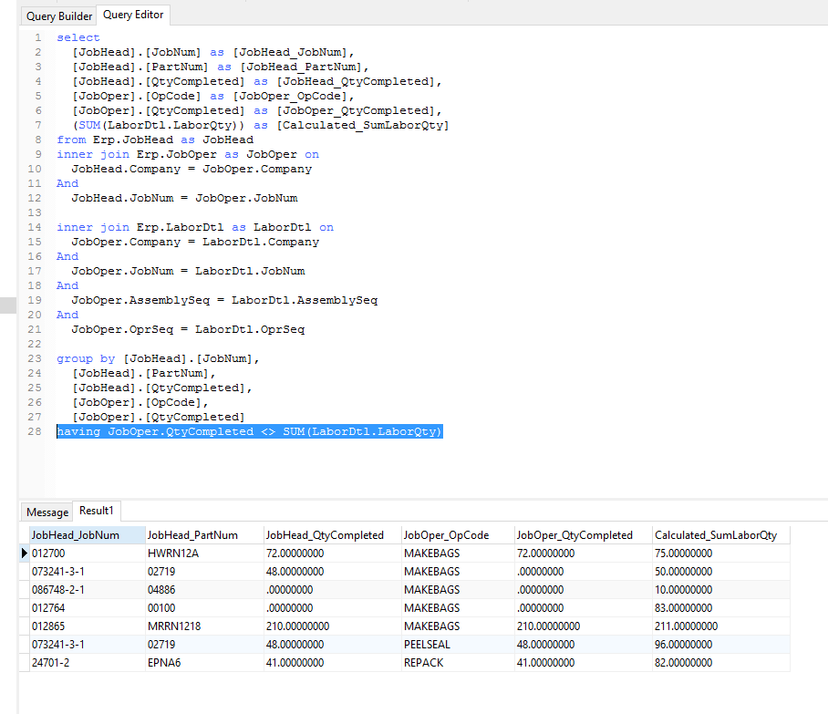

These are the actual labor dtls. The highlighted ones I’m confident recorded correctly the other ones did not or may not have.
Job 24701-2 one of those two recorded but not sure which.
Job 073241-3-1 this one is really tough, it could be that one of the 48’s didn’t record correct or that the 37 and 11 didn’t record not sure.
The other jobs there is only one labor record so it’s easy to assume those are janked up.

Submitted a ticket. This is a bug that has existed since 9.05. If anyone else has the issue feel free to reference my ticket CS0001023381. It appears centered on the LaborDtl triggers. JobPart, JobOper, and JobHead are not updated properly. Recalling and resubmitting labor records does not fix the issue. The missing qty is 80% of the time the first LaborDtl qty missing and the other 20% of the time the very last LaborDtl. Somewhere a condition is being met in the back end code that is subtracting that qty out. I have record of this issue going back before we had customizations or BPMs in place on 9.05 as well as other customers have reported the issue. There is a data fix for it. This issue is pretty big for us, we rely on that operation qty in the report qty screen to know where we are in our reporting. We end up having operators over report qty and having to go through and mop up the mess later.
