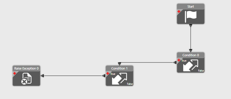

BPM
Condition 0
The ttJobHead.JobReleased field has been changed from False to True
Condition 1
Number of rows in the JobMtl query is not equal to 0
ERP.Part criteria
CheckBox02 = true
Or
OnHoldReason_c <> “”
This BPM works but when it returns an exception I would like to publish to the planner the list of Parts that are in the exception state rather than the current generic message.
Roberto.

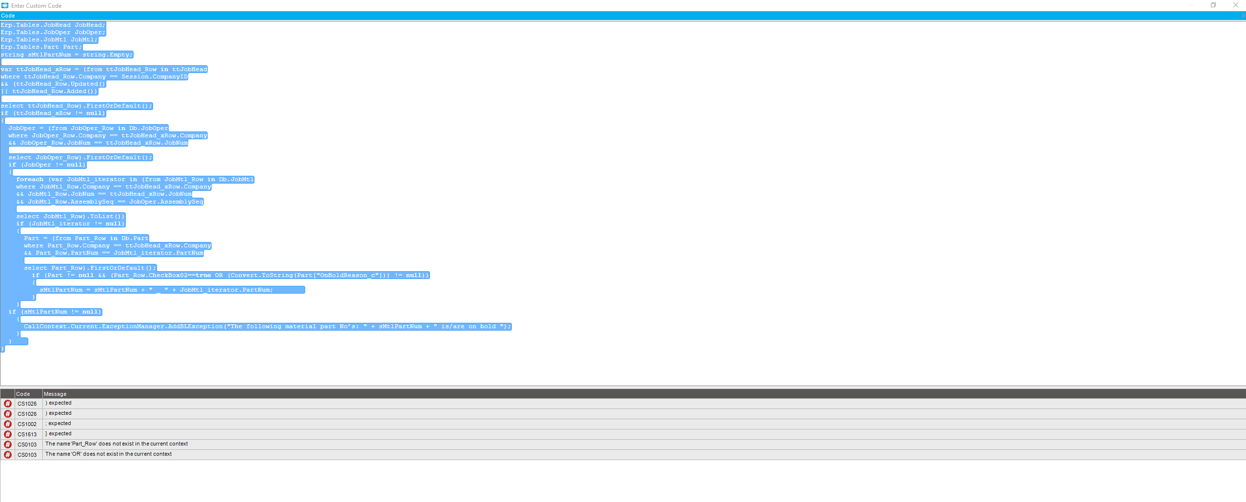

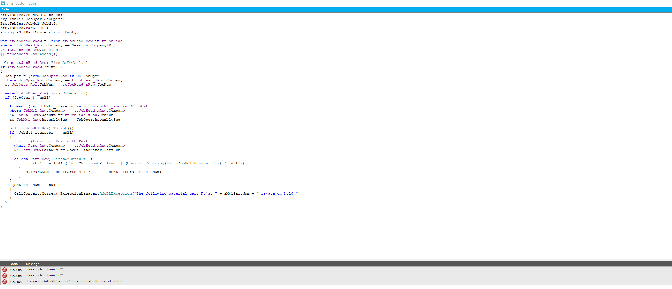

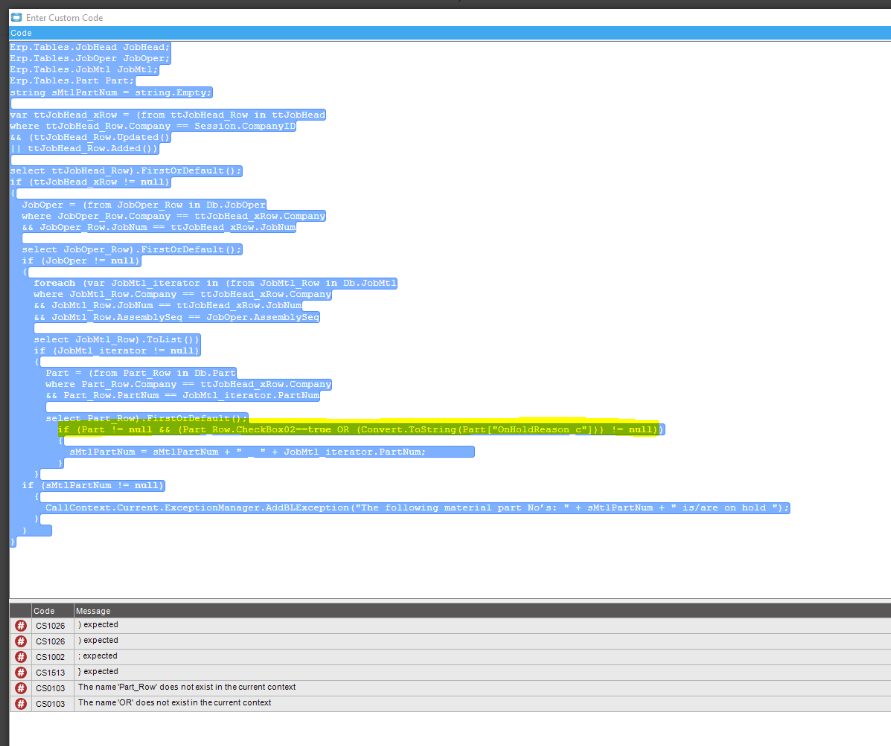

I receive the following compilation errors.
replace this line by this
if (Part != null && (Part.CheckBox02==true || (Convert.ToString(Part[“OnHoldReason_c”])) != null))
also save the BPM enabled will give more details about the error if exist
There is at least one compilation error.
Update.Pre.Validate_-JobMt.cs(200,78): error CS1056: Unexpected character ‘“’
Update.Pre.Validate
-JobMt.cs(200,93): error CS1056: Unexpected character ‘”’
Update.Pre.Validate
-_JobMt.cs(200,79): error CS0103: The name ‘OnHoldReason_c’ does not exist in the current context
normal double quotations " " not this ‘”’, my last copy-paste changed them sorry

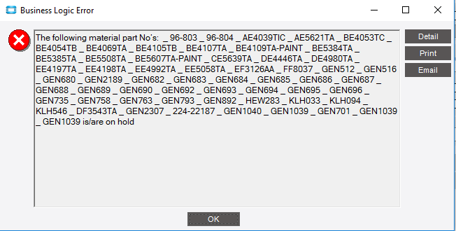

The message box however lists all Parts - not only the exceptions.
check your logic on the conditions on this code line, be sure
and to help on that you can show both values within the loop to check your list one by one:

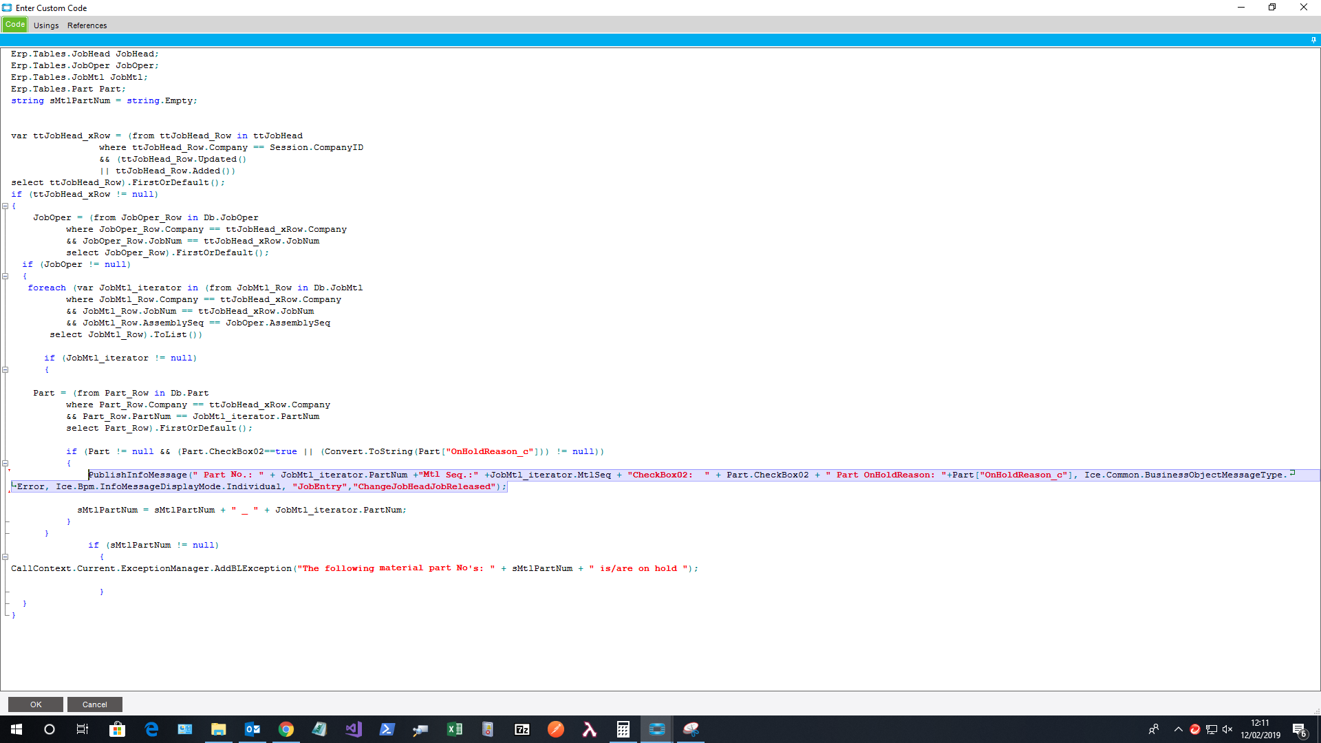

I have added in the error checking message box - but it appears I bypass it and siply display a list of all Parts within JobMtl.
Code as follows:
Erp.Tables.JobHead JobHead;
Erp.Tables.JobOper JobOper;
Erp.Tables.JobMtl JobMtl;
Erp.Tables.Part Part;
string sMtlPartNum = string.Empty;
var ttJobHead_xRow = (from ttJobHead_Row in ttJobHead
where ttJobHead_Row.Company == Session.CompanyID
&& (ttJobHead_Row.Updated()
|| ttJobHead_Row.Added())
select ttJobHead_Row).FirstOrDefault();
if (ttJobHead_xRow != null)
JobOper = (from JobOper_Row in Db.JobOper
where JobOper_Row.Company == ttJobHead_xRow.Company
&& JobOper_Row.JobNum == ttJobHead_xRow.JobNum
select JobOper_Row).FirstOrDefault();
if (JobOper != null)
foreach (var JobMtl_iterator in (from JobMtl_Row in Db.JobMtl
where JobMtl_Row.Company == ttJobHead_xRow.Company
&& JobMtl_Row.JobNum == ttJobHead_xRow.JobNum
&& JobMtl_Row.AssemblySeq == JobOper.AssemblySeq
select JobMtl_Row).ToList())
if (JobMtl_iterator != null)
Part = (from Part_Row in Db.Part
where Part_Row.Company == ttJobHead_xRow.Company
&& Part_Row.PartNum == JobMtl_iterator.PartNum
select Part_Row).FirstOrDefault();
if (Part != null && (Part.CheckBox02==true || (Convert.ToString(Part["OnHoldReason_c"])) != null))
PublishInfoMessage(" Part No.: " + JobMtl_iterator.PartNum + " Mtl Seq.:" + JobMtl_iterator.MtlSeq + " CheckBox02: " + Part.CheckBox02 + " Part OnHoldReason: " + Part["OnHoldReason_c"], Ice.Common.BusinessObjectMessageType.Error, Ice.Bpm.InfoMessageDisplayMode.Individual, "JobEntry","ChangeJobHeadJobReleased");
sMtlPartNum = sMtlPartNum + " _ " + JobMtl_iterator.PartNum;
if (sMtlPartNum != null)
CallContext.Current.ExceptionManager.AddBLException("The following material part No’s: " + sMtlPartNum + " is/are on hold ");
could you print screen the output full message, also could change the word null in the condition line to “”

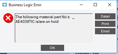

Output message as follows:
Capture5
i see, have you changed null to normal double quotations symbol as per my last suggestion ?
Changing the null to “” has returned.
Capture7
This Part has CheckBox02 ticked.
Part AE5507AA has OnHoldReason_c = 2 but does not display.
