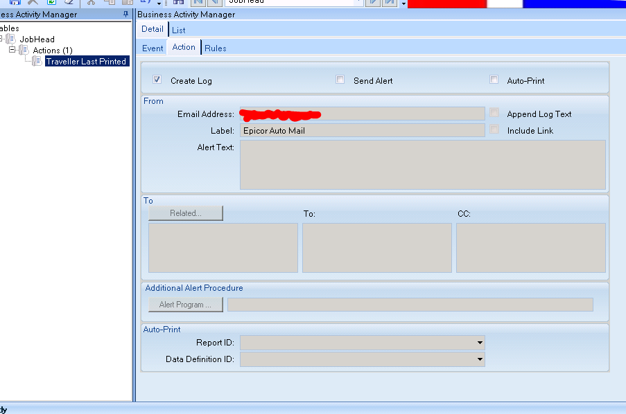

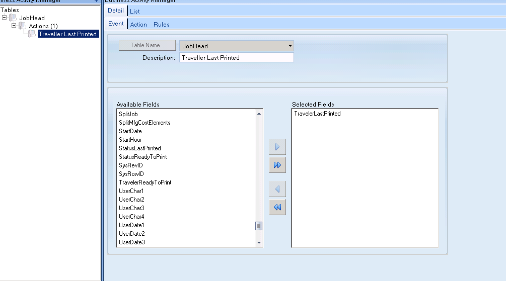

Thanks guys, i’m trying to write the BAM for it but nothing coming up in the change log at all
Im not setting a rule…as i don’t think one is needed?
when i go to a job, print the traveller, and then click the change log, i get nothing at all.
its not something stupid like the job has to be open maybe?
Just tried an open job…still no change log.
The field is updating because i exported the table into excel and saw the table/field change…so it must be the way i have the BAM setup for it not to be going through to the change log.
