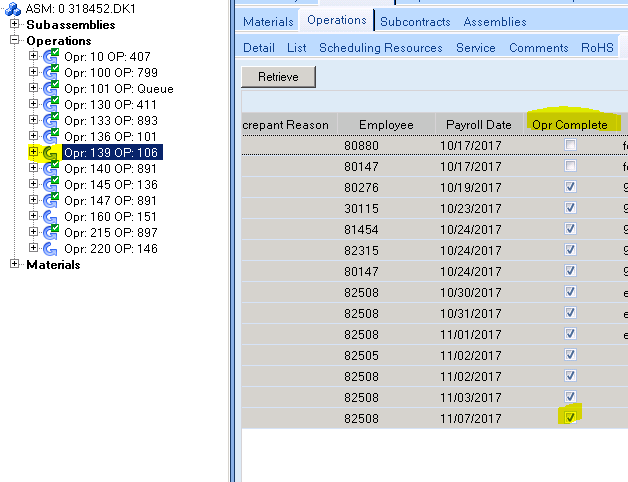

There are users logging in after the first completion. They continue to log in afterwards to record labor hours only but not qty. Based on the screenshot in Job Tracker the, the first operation completion was on 10/19/17 with multiple labor entries up until 11/07/17. After the first completion, the operation complete checkbox defaults in as checked. Any other thoughts?

As you can see in our example screenshot below, the last labor transaction is showing it as operation complete but the green check in the tree menu is not showing “green checked”. Even if a user manually unchecked the OprComplete checkbox in T&E, it would be reflected in Job Tracker as also being unchecked in the OprComplete checkbox which isn’t happening in our situation so that is what’s strange about this scenario. All labor transactions are showing as operation completed but no green check in tree menu…?
