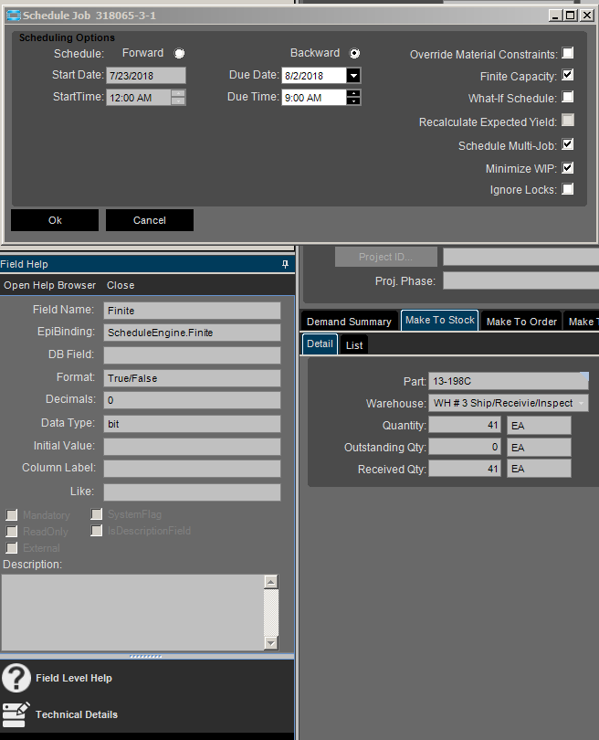

I am looking to create a query for all released (scheduled) jobs showing the schedule parameters such as ‘Finite Capacity’. When I get Field Help - Technical Details is shows EpiBinding as ‘ScheduleEngine.Finite’ I recognize this as a dll.
Where is this saved - ie what database and table?

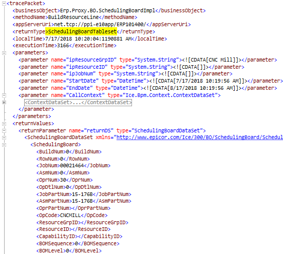

To expand this a bit, if you trace the schedule board communications, you will see it returns a dataset from the SchedulingBoard.BuildResourceLine method.
Again, it contains a lot of data that in not present on any Job table. The gant chart is generated from these calculated values - from where? It would take a lot of cpu time to recalculate these values (and every related operation) every time you pulled up a schedule board.

You’re looking at one of the tables that Epicor builds on the fly. It doesn’t exist anywhere in the database in a format that matches the dataset/tableset you’re looking at.
As far as I’ve been able to tell the finite vs infinite isn’t stored anywhere relative to the job but is something that’s defined as a parameter to be passed in whenever you setup the scheduling engine to run.
The resources do have a finite capacity option and that ultimately decides whether or not the jobs are scheduled in a finite or infinite manner. The value that you’re passing in when you schedule from job entry is really whether or not you’re overriding that properly.
If you want to see what’s actually on your schedule then you need to be looking at the ResourceTimeUsed table. That table stores the resource allocations as well as the start and end times for everything that you would see on the scheduling board.

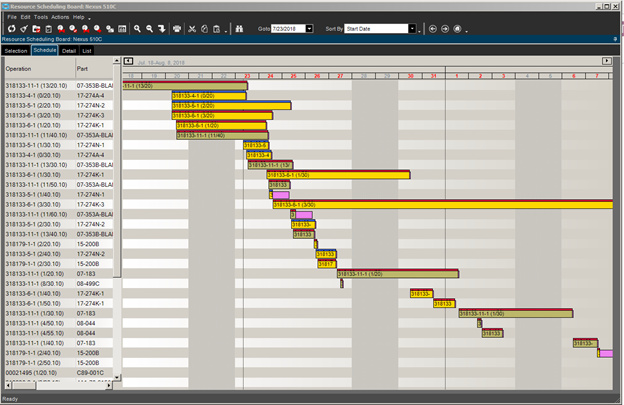

This is the operation gant chart for one resource - a Mazak Nexus CNC machine. It can only do one operation at a time. I cannot get the gant chart to be a simple finish to start schedule (Finite) All I ever get is this, which implies infinite scheduling. So, starting from the top down, here is this Site Mainenance:

A finite horizon of zero indicates that you want the resource/resource group to be scheduled infinitely.
The resource/resource group value will override the plant/site settings.
Heirarchy of settings is not well-documented.
