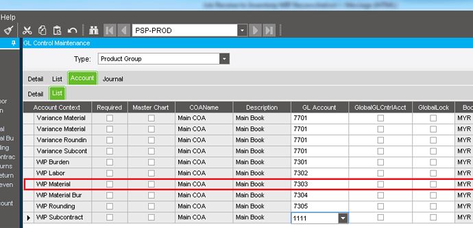

May I know GL Control Code → Product Group → WIP Material GL account figure should be 0 after capture wip reconciliation process?
Scenario:
Job Order = leejob02
Job receive to inventory value RM 107.7.
Issue material value RM 53.04
7303 figure will be RM -54.66 after capture wip reconciliation. Is it means that job receive inventory actual value is RM 53.04?
Izit GL Control Code → Product Group → WIP Material GL account logic same to AP clearing, only use for Epicor contra usage?
Appreciate for any reply…

Hi Jason, thanks for guide me.
Yes, i’m using standard costing and the job still have other costs. RM is malaysia ringgit.
I’m try another job order in test environment. After insert labor cost, WIP material gl account double entry will be 0. May I know after I capture and post this WIP reconciliation, for GL account 7301 figure will be 0 to display in general ledger? Is it any possible to display 31.18 + 50(both is manufacturing overhead and other costs) in financial report? Thanks!
