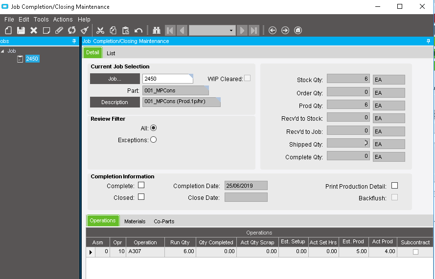

No, I didn’t received them previously. Job Completion/Closing Maintenance screen shows the complete quantity is 0

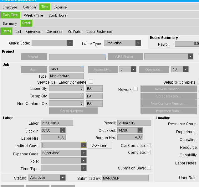

Yes, I booked the time and expenses entry actual hour 4.

Can you show a screen shot of the time and expense entry? According to the job closing screen that you showed, the quantity completed is 0. And you said that you added 4 hours, (which shows as well). So I think your problem is that you actually need a labor quantity entered, not just hours entered.
Thanks for Sandeep and Brandon. I have not entered the Labor Qty in the timesheet entry that was the issue.

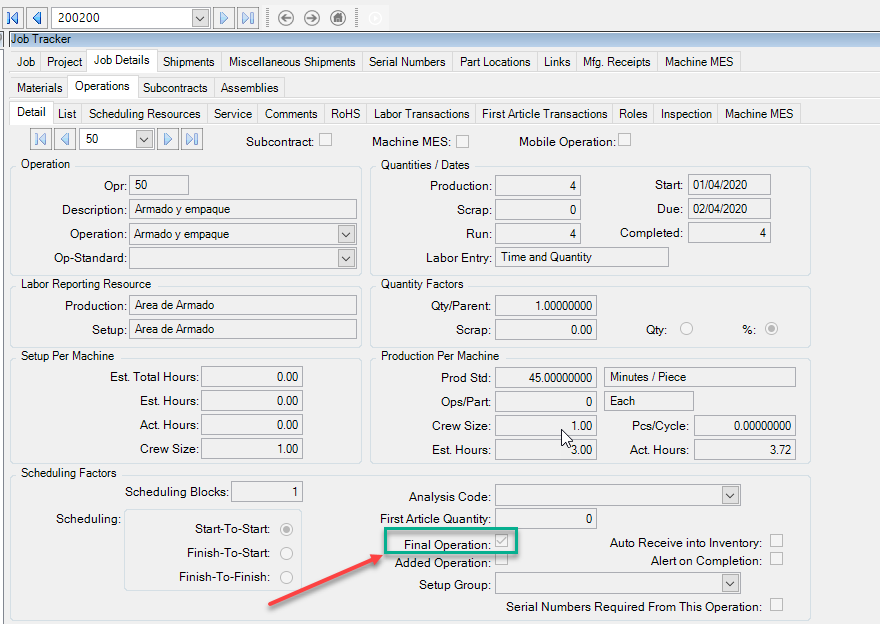

The “Qty Completed” is based on the qty entered on the last operation of the job.
Actually I had asked for screen shot of time & expense entry on that day…but in the question only u had mentioned that u had entered labor entry as well. Ok, now the problem is solved. Good luck.
There is a checkbox on every operation called “Final Operation”.
The quantity reported complete at that operation will be the quantity that is available to receive.
Make sure your methods properly specify the “Final Operation”.

You can check from the Job Entry or Job Tracker if the final operation checkbox is selected in the last operation.
So when capturing labor, it should automatically mark you on the Job Completion / Closing Maintenance screen in the Complete Qty field. the amount you entered.
