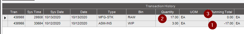

An issue was reported where a job was received into inventory, but the on-hand quantity afterwards did not add up. It’s a new stock, qty-bearing, manufactured part, and this is the first job ever being received. Our bins are all standard and nettable.

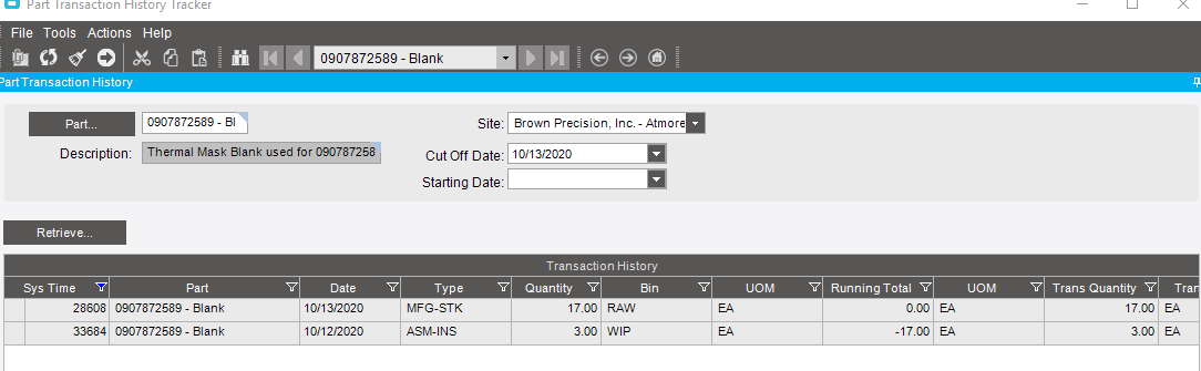

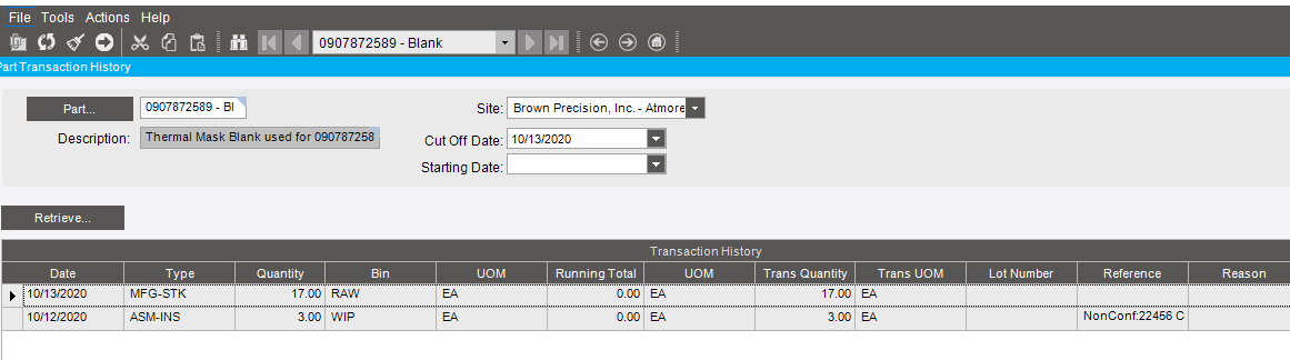

Here’s the Part Transaction History for the part:
There have never been any other transactions for this part, since it’s new.
I don’t understand why there would be a negative running total based on these two transactions.
I’m guessing the “on-hand-qty” isn’t showing on any part tracker/advisor because of the negative running total.

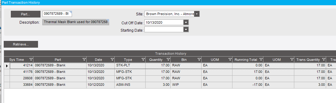

I attempted to recreate the issue by loading a backup of the db into the Test environment right before the transaction happened. I got mixed results.
When I received the job into inventory into a different (finished goods) bin, the running total column was exactly what I received.
When I received the job into inventory into that same raw bin, the running total was 0
I haven’t been able to recreate the -17 running total.

Personally, I unhide the TranNum column and make it the far left column, then I can sort by the that to ensure I’m looking at the order the transactions happened in.
What’s the ASM-INS transaction actually doing? Does that record have the “Inventory Trans” box checked?
It looks like:
  1. The QOH is -17 before the MFG-STK (at time: 28608).
  2. The above mentioned MFG-STK for 17 bumped the QOH from -17 all the way up to zero.
  3. The 2nd MFG-STK (at time: 41176), added another 17, taking the QOH up to 17.
  4. A Transfer Order Shipment (the STK-PLT) occurred for 17, taking the QOH back down to zero.
I’d focus on why it is starting with a QOH of -17. Try setting the cutoff date to 12/32/2099, to see if maybe some made an errant dat entry somewhere.

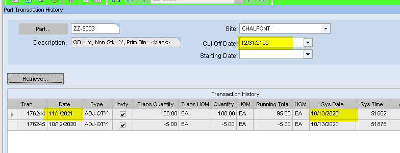

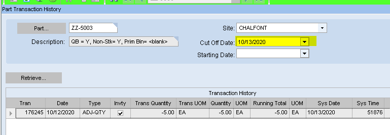

I just did a quick test of:
  1. Made a brand new part, Qty Bearing = true
  2. Did a Qty Adj dated 11/1/2021 (note the year), for +100
  3. Used Part Tran History to view it and see no part transactions (left cutoff at the default of 10/13/2020)
  4. Did another Qty Adj dated 10/12/2020 for qty -5
  5. Part Tran history (with default cutoff) shows:
Changing the Cutoff to 12/31/2199 and it shows:
What this shows, is that the Running Total isn’t based on the order of the transactions, but rather the order of the “Tran Date”
In my example the +100 ADJ-QTY happened before the -5 ADJ-QTY. But the tracker displays the -5 QTY-ADJ “first” (on the bottom of the grid), because it has the early transaction date. And then does it does the math starting there.
So include the System Date in the Grid!!!

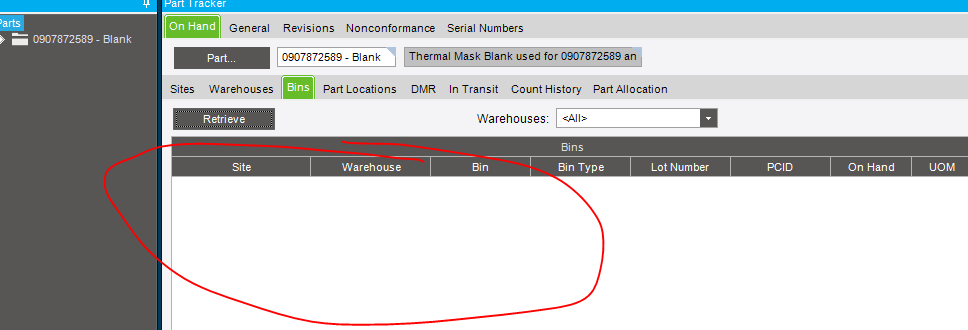

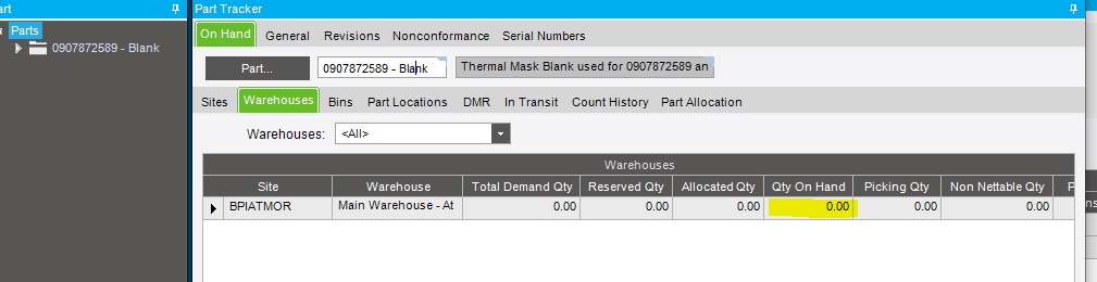

I see what you mean, unfortunately the “Running Total” confusion is only part of the issue. The main thing is the actual QOH for that part in PartBin table isn’t getting updated after the receipt to inventory. I was assuming it was related to that running total.
I loaded our Test environment with a backup that was directly after the initial job-receipt-to-inventory transaction. This is the transaction where people noticed issues (since they couldn’t do anything with the inventory they just received in “No QOH for part”).
So the main issue (in addition to the Running Total column not making sense) is that after the receipt to inventory, our QOH in the bin it’s received to does not reflect the transaction quantity. Part tracker claims there’s nothing on hand at all.

The first screenshot actually looks correct (except for the Running Total in the first (oldest Record) ).
  1. Tran 438955 was not an Inv-Tran so its Tran Qty of 3 has no effect on the “Running Total”. But no idea why the Running total is already at -17.
  2. Tran 438988 (MFG-STK) was for +17
  3. The Running Total (after the MFG-STK added 17 to -17 (the prior Running Total)), gives you the zero QOH.
I really think the problem lies with why the Running Total is starting with -17.

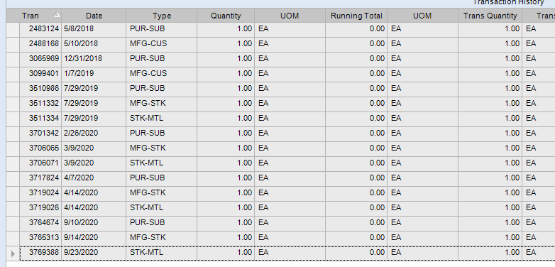

Recently went live on E10 in mid-September. Today, while preparing for Physical Inventory, we ran across 2 job receipts having very similar behavior. Running Total qty was -1 for a while, even though the users never observed an issue with it in E9. The receipt to tie up the job for PI just raised the on hand to 0.

The Inspection (-INS) transactions is taking the quantity off of stock. If you click Part Locations then Inspection & Retrieve you’ll see the 17s in there.
It’s just that the -INS transaction was only for quantity of 3, and it’s not reflecting that. When I completely redid the transactions using a backup I got the expected results, could not recreate the issue.

@Michael_Ramsey I think, like @ckrusen said, it’s an issue of going from non-QB to QB. The screen calculates backward from OH today, and doesn’t understand that the QB setting can change. This seems really likely in your case, since it started out life as a make to order part (MFG-CUS).

@JasonMcD just to compare, the transaction history from Pilot DB…
Would Change Log show the flip of QB? For this part, I only see 3 changes, Non-Stock flag flipped around back in Jan-2019, twice, and then min order qty changed from 0 -> 1.
PS: Well, I can research Change Log, appears those things are configurable,
@Michael_Ramsey Well it’s all zeroes there in Pilot. So either it’s non-QB now in pilot, or you are viewing it from a different site.
Change Log is whatever someone set it up to be. It may not be set up to show QB, and it may be set for Part and not PartPlant (the one that matters).

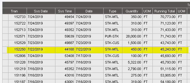

One thing I’ve found in the Part Tran History form is that the Running Balance column is only accurate when the grid is “unsorted” - meaning the data rows are in the order that the internal query process returns them.
For example, the highlighted row is “out of order” if you go by the TranNum, but in order by TranDate.
The running balance is correct, as the prior balance (line below it) was 45,693 FT, and this transaction (a STK-MYL) reduced QOH by 450 FT, resulting in a balance of 45,243 FT.
If it is sorted by TranNum, you get:
And the Running Bal for the highlighted row is not equal to the row below it +/- this row’s tran qty.
It’s best to remove any sort.
