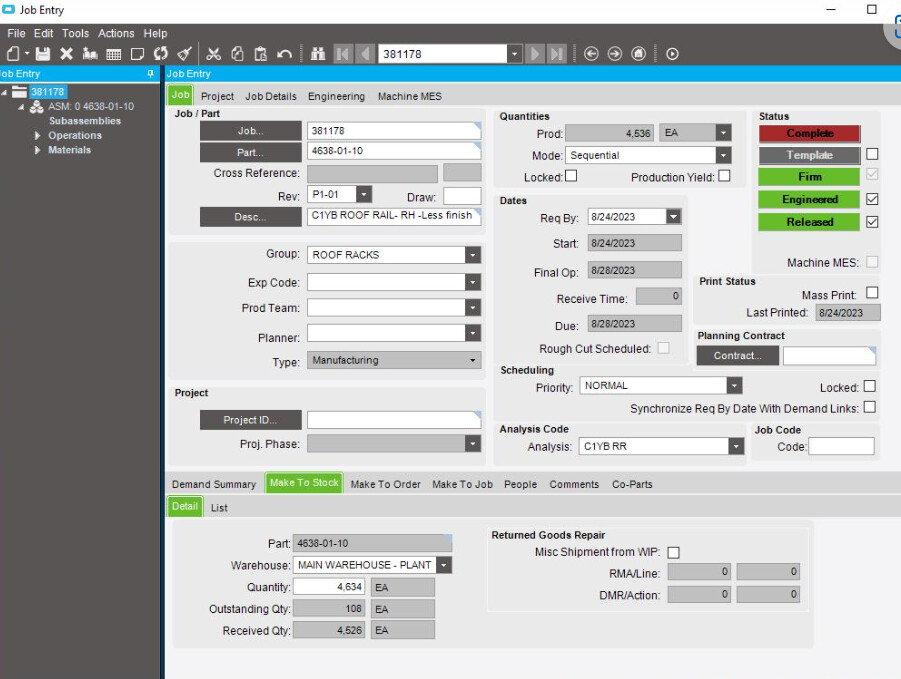

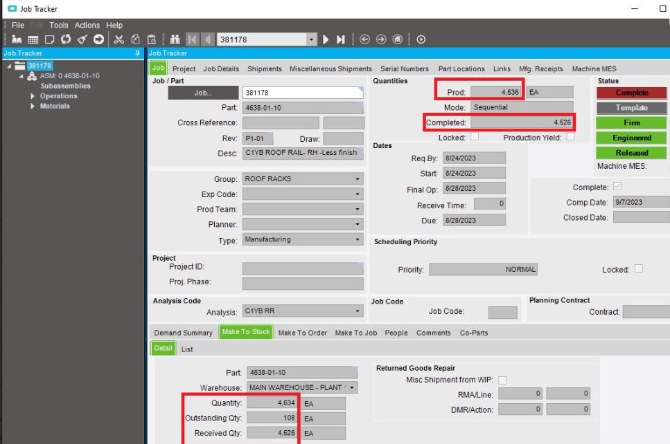

Hello Folks,
I just to understand the root cause and correction of this issue.
For example below - the job was initially created for 2184 pcs but then they ended up manufacturing (reporting) 4634 pcs total (108 parts rejected off the job, leaving 4526 pcs going into inventory). Plant 1 Supervisors updated the job qty to 4634 pcs so they could mark it complete for closure but when they did, the Production Qty did not change - it shows 4536? One of the attachments below says the material requirements saying we need less than what was backflushed to the job. The other shows the job in job tracker and highlights the numbers I am referring to here.
I have not come across this in a while but now have 2 jobs for Plant 1 that I cannot close. I want to know;
1.) Why or how does this happen?
2.) Can it be fixed or corrected?
To change prod qty, you have to un-engineer the job and change it right there in Job Entry Demand tabs. Personally, I don’t touch that field unless we’re doing a job split or actually inc/dec planned qty on the job by significant amount. It’s the nominal planned qty. It’s okay if actual qty is a bit over/under, especially on large runs of small items.
To adjust completed qty, go into job adjustment, find the last op and adjust qty up and down as required. You can also go into T&E entry and tweak the qty claimed on individual labor entries.
Received qty comes from the job receipt transaction. You can’t really undo those.
We run the “Production Yield Recalculation” process every night to handle these situations. The process updates a job’s production quantity based on the quantities reported on completed operations. The “Production Yield” checkbox needs to be checked on the job for it to work.
