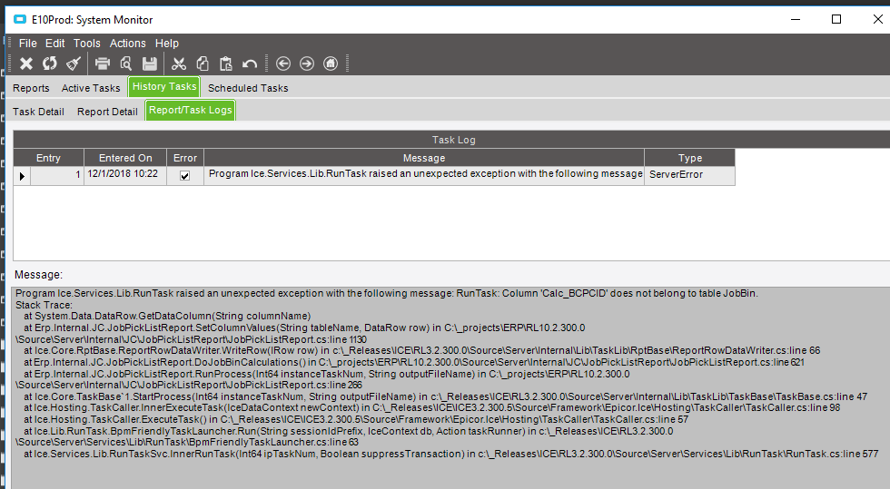

10.2.300.5 Job Pick List report (out of box) does not work. It was working in 10.2.200.12.
This is the error…
Bad part we are in the middle of go live and this is critical for us…figures right…LOL
We have opened ticket with support and seeing if we can work around this; but just wanted to give a heads up. I will update later after support.
I saw a similar error in our system when releasing the job. Does it happen for every part? In our case the issue was with that specific part’s BOM was missing. The system thought it had the BOM because it was listed as a manufactured part but there were no subassemblies attached to it. Might wanna check the database.
