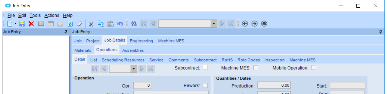

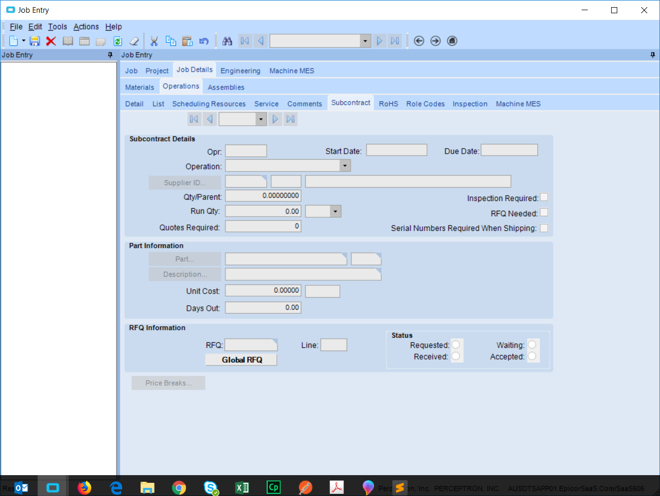

Operations. Subcontract Tab.
Mark W.

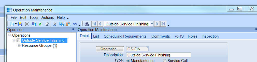

Did you mean on the Method?
Yes, sorry about that Kimberley.
Since our stuff is usually make-to-order, we do it on the Job but you could certainly do it on the Method as well.
Mark W.
Yes we do have the Subcontract check box checked on the Operation. I noticed that some of our resources on Subcontract don’t have subcontract checked. I would say it needs to be checked correct.
