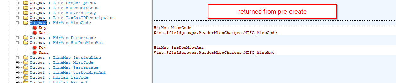

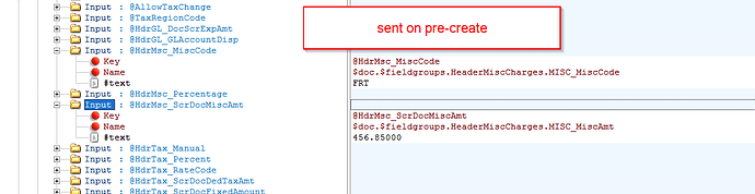

Do you have anything else populated on the hdrMsc inputs besides the MiscCode and the Amount?
This is what I’m sending in. I can’t figure out why it won’t return anything.
It’s the same thing with create. But it creates the misc charge in Epicor, just doesn’t send back anything.

Nope, just those two variables. This is the case for each miscellaneous charge we may require. This is being done in a workflow step created just before the Pre-Create which populates the HeaderMiscCharges field group.
