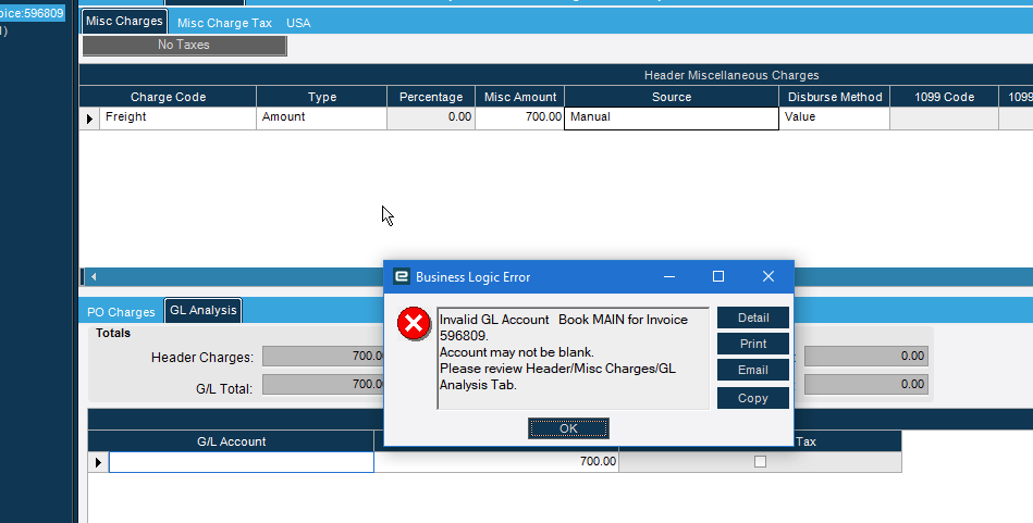

I wonder if it’s a GL account issue? I did notice that the system is returning a blank GL account row. When I do this in Epicor, I get no GL account automatically.
Huzzah!!! that was is. The Gl wasn’t set, if I add that GLHeaderAnalysis line and fill it it, it now sends me back an error that says it’s wrong (because it is, and I don’t know anything about out GL codes), but at least there is a path forward to fix that. So if that isn’t set, and Epicor doesn’t set it automatically when the header charge is created, instead of sending back the error of missing GL line, it just doesn’t send the HdrMsc back. (still a bug in my mind… but at least I have a valid workaround now)
