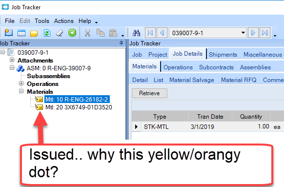

Job Material Status Icon
We have issued material to a job, but instead of getting the usual green checkmark, we’re getting this yellow/orange color dot. Looking at the job tree application help for the icon, it’s not there.
Anyone know what this yellow color dot on job material means?

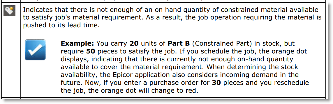

This is from an older TreeView document (the dot looks different in more recent versions), but it looks like it’s caused by not having enough of a constrained material on hand.
JobEntryTreeVi.pdf (132.3 KB)
Thanks Matt. For our case this’d be a fluke since the materials have been issued already. I do notice some interesting more part trans than there should be on the one material, however, so I guess I’ll just assume that this is how it got some idea that there were some constraints.
