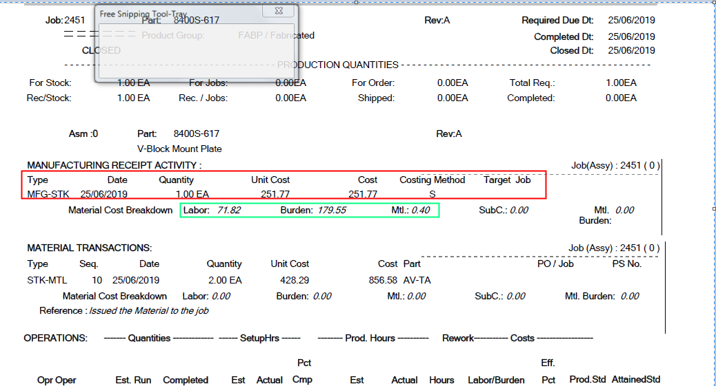

I just want to understand, how does the material cost breakdown calculated ? which is highlighted in the green. - Inventory/WIP reconciliation report shows difference cost and production detail report material cost breakdown shows difference cost.
Thanks for your help in advance.
all costs are not being captured at time of Job receipt to inventory.
Does the final Operation have the Production QTYs entered? For example if the Job needs 200 made, has production reported the 200 QTY?
The Production QTYs affects the captured costs at the receipt to inventory.
Yes, it produced.

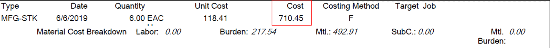

This is other strange thing in the job costing MFG-STK shows below the cost 710.45
Whereas, Job Actual Cost show below. I failed to understand on these disparity it supposed to 1420.90 but MFG-STK shows 710.45 which incorrect costing.
