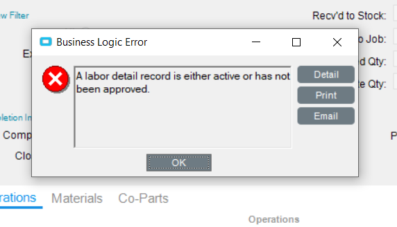

I am trying to close out a job in Job closing and I am getting this error? I have double checked to make sure nobody is clocked in to this job and I’m still getting this error? I’m not sure where else to check?

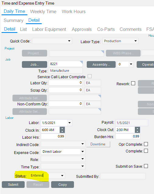

You have a record in Time and Expense Entry that is not submitted.
You could do a BAQ to find it pretty easily.

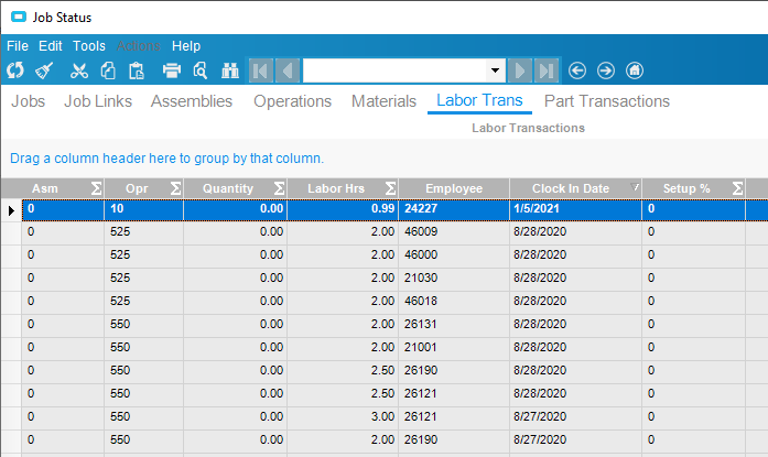

If you are not comfortable with BAQs yet, there’s a screen called Job Status (not the report and not the maintenance one; the one in Executive Analysis) that lists all labor transactions. It won’t say if it is submitted or not. But you could start looking at T&E records that way.

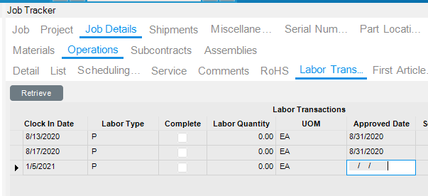

Also, Job Tracker shows the approve date:
Pain with that is that you have to go through each operation one at a time, looking for the blank.
Note: I moved that column over.
Thank you for your help! I made a BAQ and found where the problem was!
