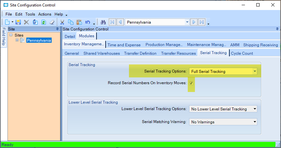

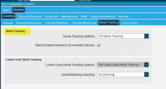

Do you have track serial numbers on inventory moves setup in site configuration control?
Nancy
Hi Nancy,
yes, i have this setting.
Ok, and do you have part(s) setup for serial tracking on the part master and individual sites too?
With site configuration as above and part(s) setup on part master for serial tracking, you should be getting a request to enter serial number for every transaction on the part (e.g., mfr it, receive it, transfer it, dmr it, etc etc).
