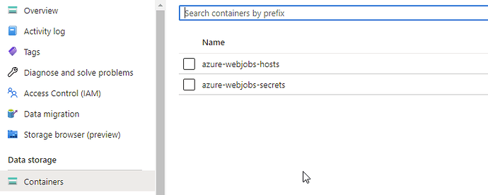

Anybody having issues with Azure cloud ? I have a HTTP function there which stopped working a few days ago. It was working perfectly before and nobody touched anything since then. I see the same error every time ‘There was an error performing a read operation on the Blob Storage Secret Repository. Please ensure the ‘AzureWebJobsStorage’ connection string is valid.’ I can see some issues with Azure storage but it says it is only for Brazil region and I am on West Europe plan. The connection string is OK and the function runs just fine locally.
I spent the whole day yesterday checking all settings and logs. The only thing updated in that whole portal in the last month was the payment method. I just don’t understand how can it work for hundreds of times and then all of a sudden crashes every time.
