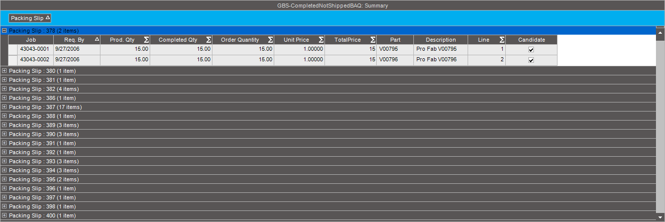

Looking for some documentation or help regarding how to create a row that has TotalPrice totals.

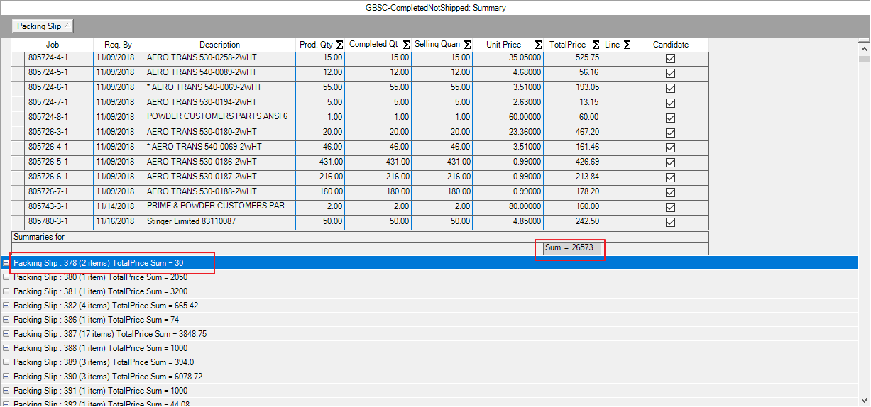

I’m trying to duplicate a BAQ/Dashboard that was created in Vantage 8, we are now going to Epicor 10. The BAQ I’m creating is grouped by Packing Slip, but I’m wanting it to show TotalPrice Sum at the bottom of the grouping and on the summary.
Wasn’t sure where to look for information on this.
