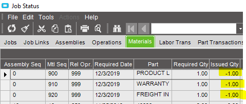

Issued Qty on Job is NEGATIVE 1
In three years, this is a new one to me.
I think the culprit is that we added a new last operation midway through backflushing and returning and job adjusting. The job adjustment for -5 on the operation when only 4 EA material was issued was the nail in the coffin.
Prat transaction history:
Not looking for help; it’s pretty obscure. Just FYI for anyone in the future.
Also, backflushing on the job closing screen fixed it–it issued 2 EA to go from -1 to +1.
