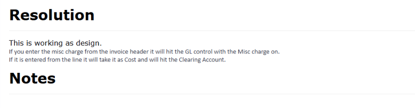

I reviewed this KB, but the answer doesn’t seem sufficient. Has there been any progress on this issue since 2019?
https://epiccare.epicor.com/epiccare?id=epiccare_kb_article&sys_id=36c72792db5b23806a0493b7f496196b&table=kb_knowledge&searchTerm=AP%20Invoice%20Misc%20Charges%20inline%20Posting%20to%20Wrong%20Account
From my understanding:
  • If you enter the misc charge at the invoice header, it will hit the GL control associated with the misc charge.
  • If entered at the line level, it is treated as a cost and hits the Clearing Account.
Why Epicor has been designed like that?

According to Epiccare, It is working as designed. If you expense the freight at the header level then it goes to freight gl control. If you allocate it at the line level it is because you want the expense to be included in the line cost
You have selected Accounting with Inventory receipt flagged as Yes. Which means at the time of GRN it is Dr Stock and Cr Clearing account. Hence, at the time of Invoicing it is adjusting Clearing account to zero. If you want to handle it differently then un-tick the Receipt flag at Company Configuration.
