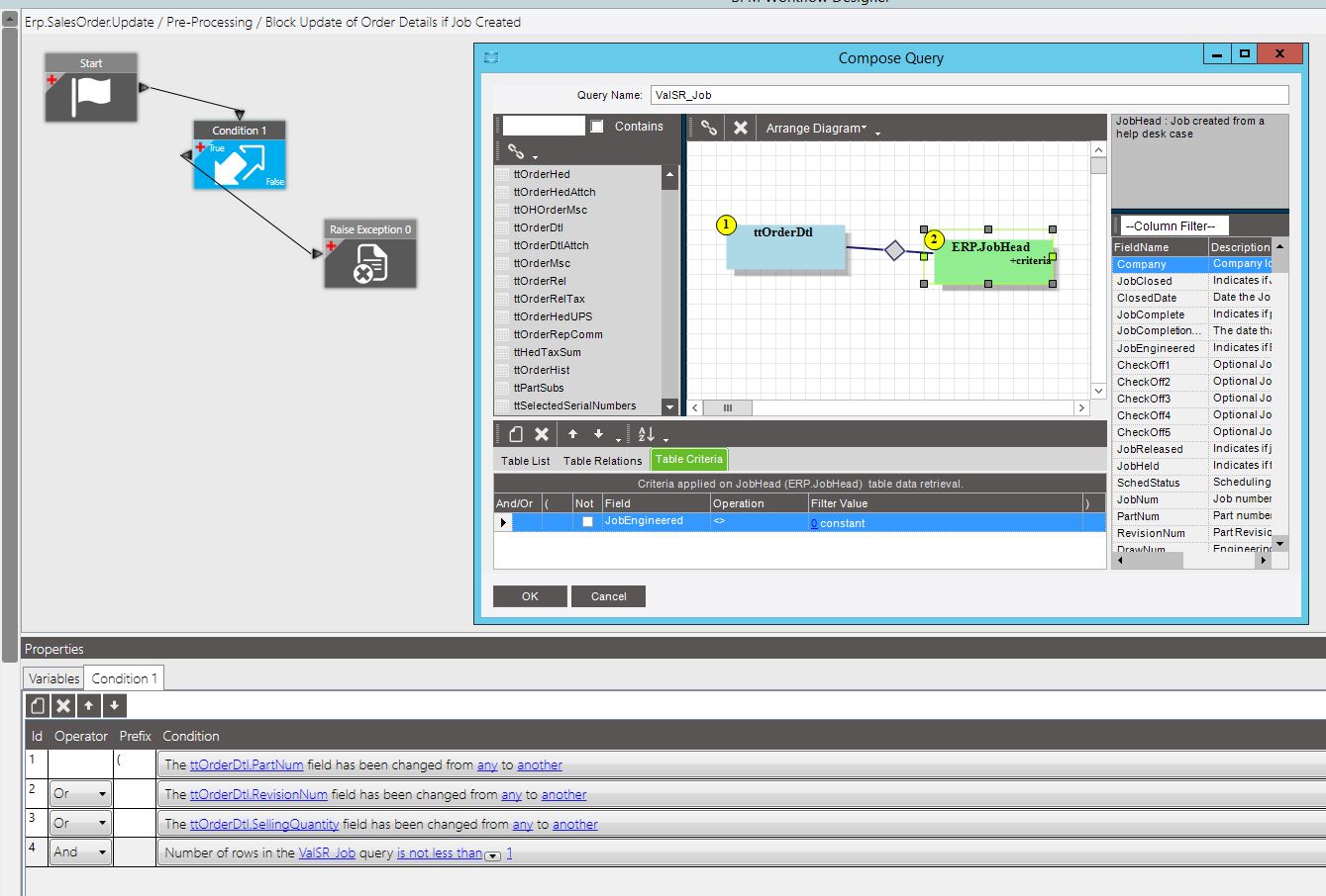

To try this without the custom code block (the Epiusers.help certified way), you can set those fields from the ttIssueReturn as variables with the “Set Argument/Variable block”
EDIT: Replaced picture to include true rather than the error prone 1 in the criteria’s bool statement
So if there’s a record on the JobMtl table that meets the Table criteria, the error will throw.

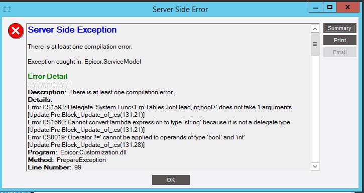

Even though I did the validation step after entering the two “Set Argument/Variable” command boxes, and after the “Condition” box and the “Raise Exception” box, it gave me the following compilation error when I tried to enable it:
Server Side Exception
There is at least one compilation error.
*Error Detail * ============ Description: There is at least one compilation error.
*Details: * Error CS1593: Delegate ‘System.Func<Erp.Tables.JobMtl,int,bool>’ does not take 1 arguments [PrePerformMaterialMovement.Pre.StopMakeDirectPa.cs(121,21)] Error CS1660: Cannot convert lambda expression to type ‘string’ because it is not a delegate type [PrePerformMaterialMovement.Pre.StopMakeDirectPa.cs(121,21)] Error CS0019: Operator ‘==’ cannot be applied to operands of type ‘bool’ and ‘int’ [PrePerformMaterialMovement.Pre.StopMakeDirectPa.cs(123,28)] Program: Epicor.Customization.dll Method: PrepareException Line Number: 99 Column Number: 13 Server Trace Stack: at Epicor.Customization.Standard.CustomizationCompiler.PrepareException(CompilerErrorCollection errors) in C:_Releases\ICE\3.1.500.15\Source\Framework\Epicor.Customization\Standard\CustomizationCompiler.cs:line 99
Within the Pre-Processing step, when I hit “Validate”, it always reports “Directive validation succeeded. No issues were found”, which is obviously not the case.

I think I see a possible reason for the error in some of my snapshots…The BAQ designer for BPM’s is slightly different than the normal one. It needs true and false for boolean types, 1 and 0 will throw errors. If you used my images above (sorry!), try changing all 1’s and 0’s in boolean statements to either true or false (no quotes, all lower case)
I’m still getting an error on the Method Directive. I was getting an error that said ‘True’ didn’t exist in the current context so I changed it back to one. It made no difference.
I did remove the Direct = 1 condition and there were no other validation errors but then I had to put it back in, and it’s unhappy again.
Here’s the first portion of the Server Side Error:
I googled the “Delegate ‘System.Func<Erp.Tables.JobMtl,int,bool>’ does not take 1 arguments” and realized its trying to tell me its looking for another argument but since its one line of criteria that are restricted by drop-down options, not sure how I’d provide another argument.
Also, I did build the Data Directive in lieu of this one and it still allowed the Direct material to be issued (and yes I had it enabled) so don’t know where I went wrong there either. Clearly I’m not providing the right criteria for it to stop the issue.
Still circling the airport but grateful for your input and suggestions Adam!
Did you try True or true? If you did True (capital T), try true (all lowercase no quotes) I THINK your error is still related to the boolean statement. Still kicking myself for giving you bad pictures… here’s a post with that error message. OP has issues with 0 and False, finally false worked.

I finally got the Method Directive BPM to work… by changing the Boolean comparison value to ‘true’ from ‘True’. One little letter.
