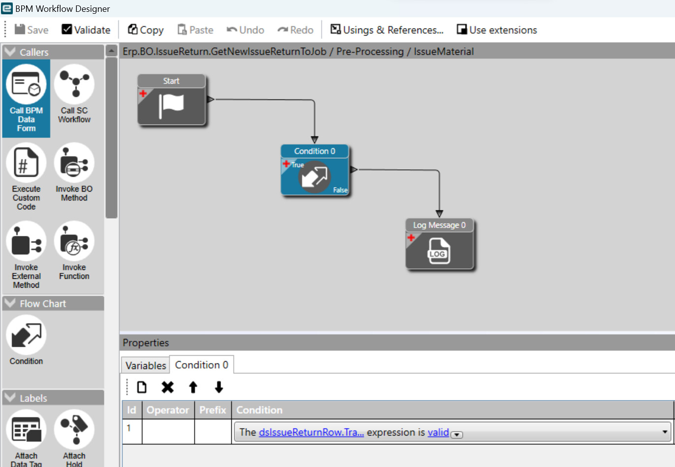

I have a BPM for that, which uses a bunch of widgets for conditions and set variable and messages. So its not a single piece of code I could easily copy.
I used: “Erp.BO.IssueReturn.GetNewIssueReturnToJob” and pre-processing with the condition:

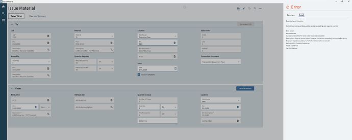

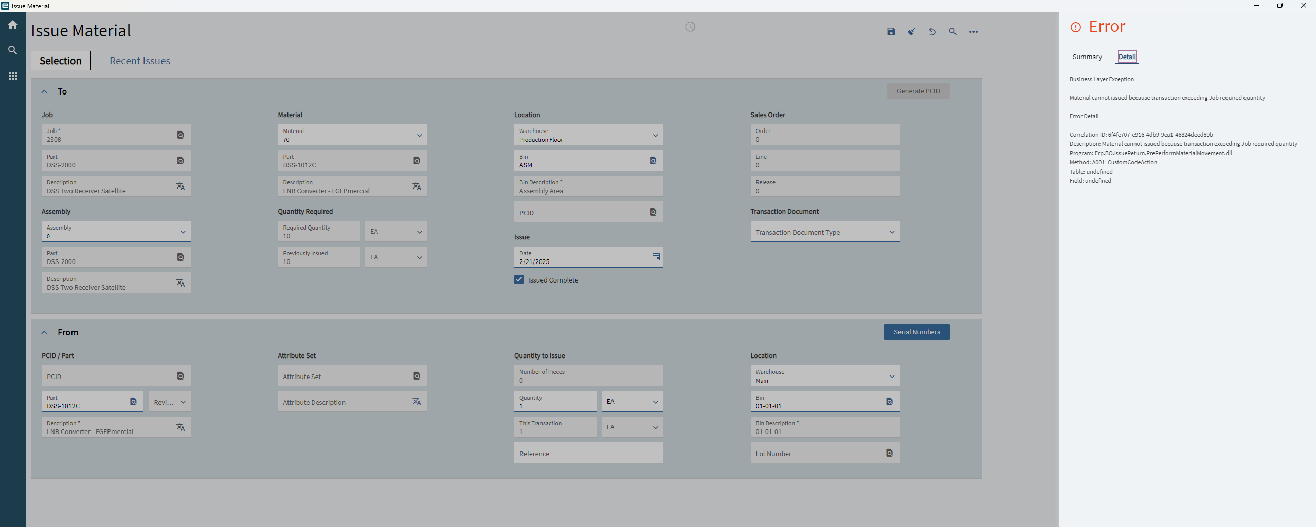

10 pieces of material are required and already issued so cannot issue 11th piece.

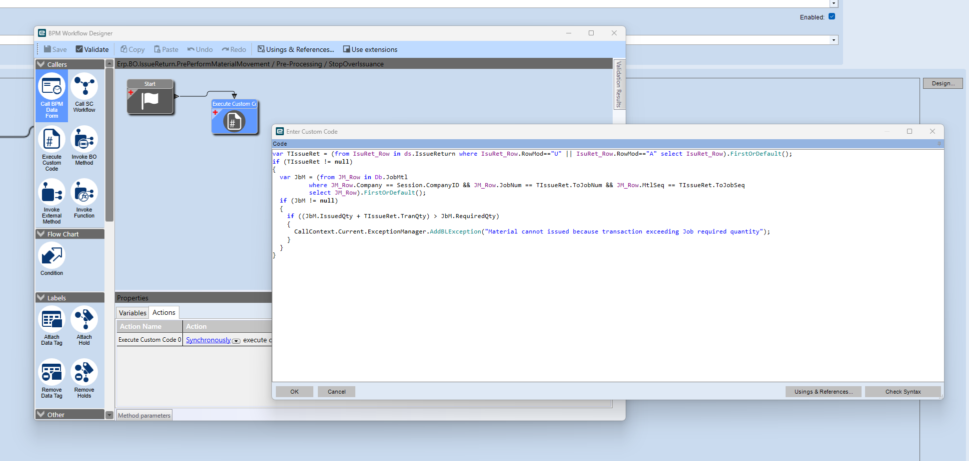

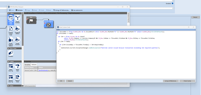

Use “execute custom code”
Below is the code you can put in the “execute custom code” node
var TIssueRet = (from IsuRet_Row in ds.IssueReturn where IsuRet_Row.RowMod=="U" || IsuRet_Row.RowMod=="A" select IsuRet_Row).FirstOrDefault();
if (TIssueRet != null)
  var JbM = (from JM_Row in Db.JobMtl
          where JM_Row.Company == Session.CompanyID && JM_Row.JobNum == TIssueRet.ToJobNum && JM_Row.MtlSeq == TIssueRet.ToJobSeq
          select JM_Row).FirstOrDefault();
  if (JbM != null)
    if ((JbM.IssuedQty + TIssueRet.TranQty) > JbM.RequiredQty)
      CallContext.Current.ExceptionManager.AddBLException("Put you error message here");
In my BPM, I also checked if the TranType was STK-MTL. If it was, then I knew the TranQty was being added (issued) to QtyPreviouslyIssued; otherwise, it was a return and so TranQty needed to be subtracted from the QtyPreviouslyIssued, and a warning generated that the material line would now be under-issued.
Yes, TranQty will be negative figure in case of return material. So condition will automatically subtract in my code and will allow transaction to process.
Thank You Great its working
