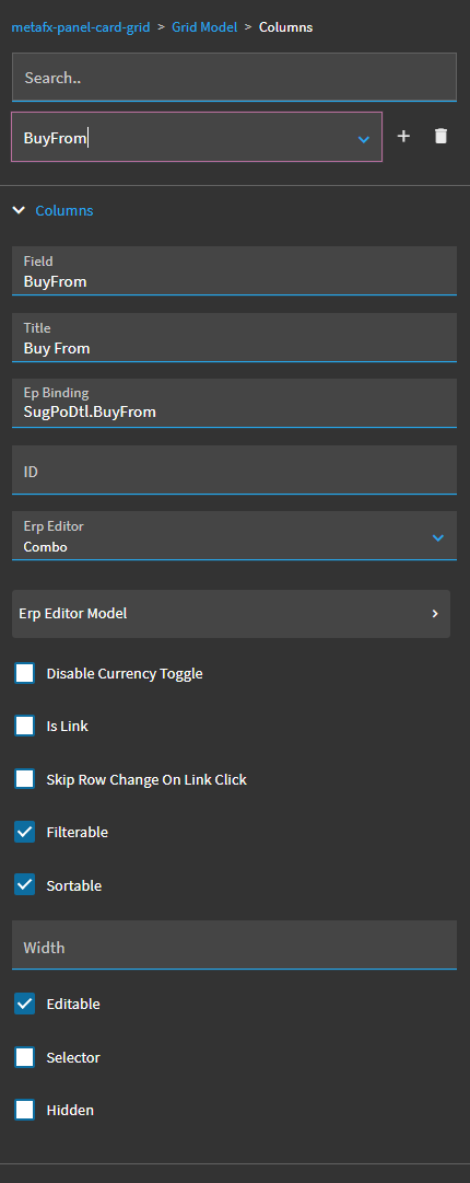

I am trying to add a combo box to the grid panel of “Erp.UI.POSuggEntry” New PO Suggestions.
The first image shows the options populating because they appear as filter options.
(replaced original image with a redacted version)
However, I cannot open the drop-down list to change the selection.
Here is my configuration:
I have completed the following troubleshooting steps:

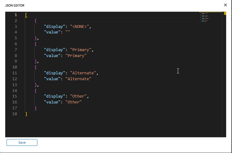

  1. Added the options via metafx-panel-card-grid > Grid Model > Columns > Erp Editor Model > List
  2. I have attempted to start with a ‘fresh’ layer with only the combo box
  3. I’m pretty sure the other configurations I tried are wrong, so I will not document them here.

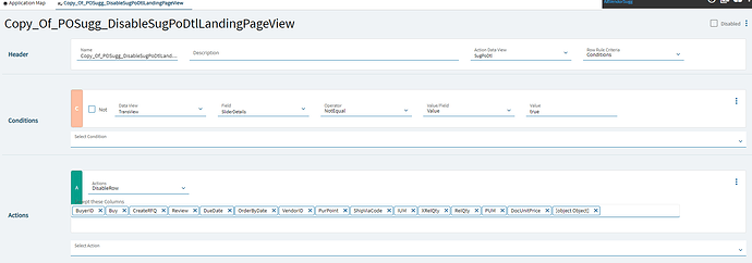

Check if there are any data rules making that field read only.
You may have to add an exception

I’m still fairly new to customization development in Kinetic and I’m trying to understand how that would work.
Could you explain how that would work because I am struggling to see it.
Specifically, since the base layer has ‘sysDisableLandingPage’ and ’ POSugg_DisableSugPoDtlLandingPageView’ which are locked, wouldn’t the original filters still disable the field regardless of any filters or copies of filters I make with an exception for my added columns?
It seems like I would need to enable things instead, but I’m not sure how I can accomplish that.

There are fields that can be modified, and it seems like that is based on the following filter:

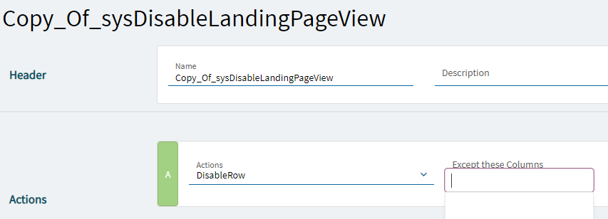

So you could copy that data rule and add your column to the exceptions … and then disable the original data rule

How do I disable the filter? it is locked, and I do not seem to have that option.

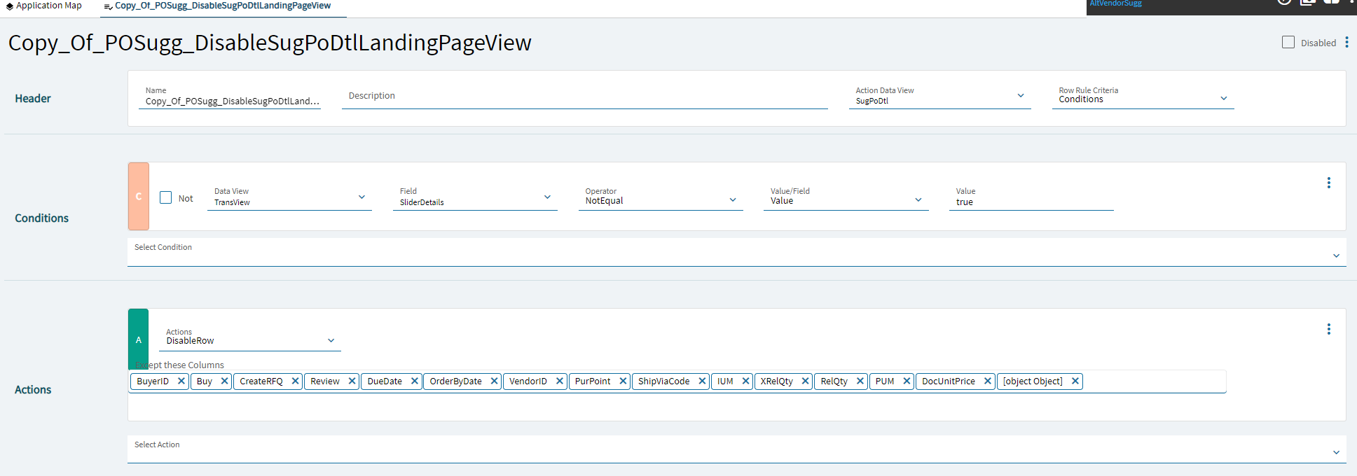

Apparently, you might not have to disable the original rule
I tried that; it didn’t seem to work in my case, but it could be because all my custom columns are coming up as [object object] for some reason; they are also displaying that way in the data view.
