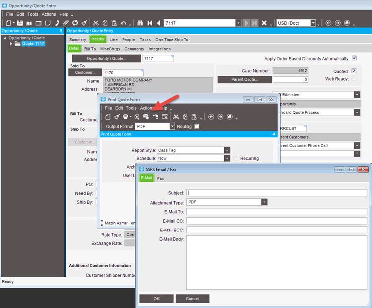

The issue is with emailing business documents such a Quote from the Print/Email/Fax option. For example, when selecting to print a quote, Epicor 10.1.400.38 provides the option to directly email it. The email window is populated with the subject line, EmailTo, EmailCC, and Body. Not there is no field for the EmailFrom. The Quote is submitted, emailed, and received. However, when the received reply back, the generic email address from the Global Alerts setup is defaulted for the email Sender. This email address is a generic email defined to avoid an error message from the field is blank.

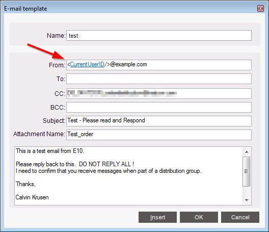

We have Adv Print Routing, and take advantage of the fact that we make the users E10 ID equal to their domain user ID. Then you can inert the system constant CurrentUserID , immediately followed by a static value for the domain.
I am currently using the existing email function
Yeah… The built-in email is pretty limited. Can’t change the From, or specify the attachments name.
Adv Print Routing is handy for some things, but mostly for just automated things. With APR, none of those fields you see (Sunject, To, CC, Body, etc…) are displayed. They are all derived from the data of the item being “printed”. The pict I showed is for the Template of the email. all fields are either static constants (every email contains the same info for the same fields), or is built dynamically at runtime with no user input.
