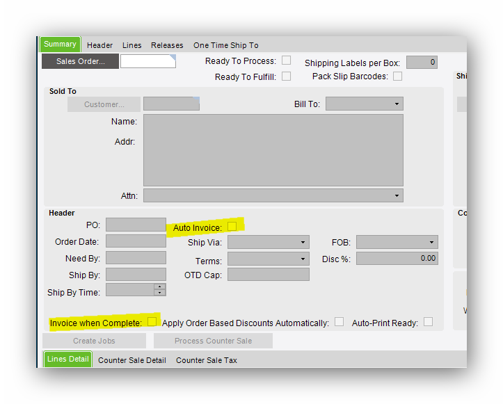

There are two fields in Order Entry that look to be related. They also have corresponding fields in Customer Entry for default values. We don’t use auto-invoicing, but the help documentation makes it sound like no invoice is created and that the Customer pays directly to the pack.

Mr. Tyler : Thank you for the suggestions and screen shots. Both of those AutoInvoice and invoice when complete checkboxes are unchecked.
