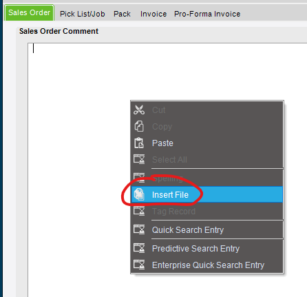

Is the "Insert Text" function in the Classic UI not available in the Kinetic UI?
In our 2022.2 Classic UI we are able to right click in a text editor and use the Insert File function.

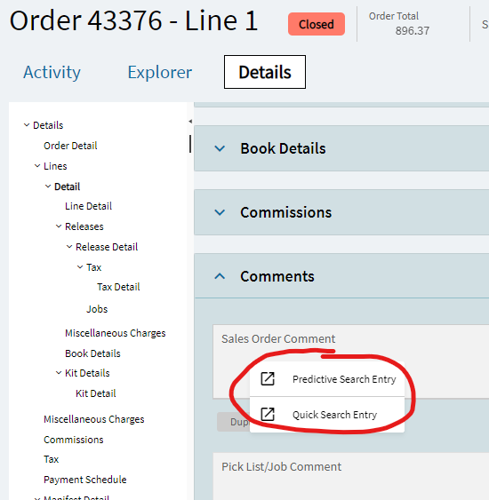

When right clicking in a similar text field the 2022.2 Kinetic UI the Insert Text function is not available.
Is there a was to use this function in the Kinetic UI?
I didn’t notice that was missing, but I do absolutely miss my right click, calculator.
This idea has the Insert File bundled into it.
Spell Check in Comments text boxes
Thanks Chad! I’ll look into it.
There’s an idea for that too!
https://epicor-manufacturing.ideas.aha.io/ideas/KNTC-I-2775
We submitted a case for this last year and were assigned PRB0248537 for this. As of 6/6/24 the state was still “Accepted - Not Yet Planned”.
@WendyNRI We submitted a case for this as well and they gave us the same PRB. Did you figure out a solution for this? I asked them if Development was even looking into this because based on the response from the admin on Oct 30, 2024, they are not going to move forward with the idea.
The implementation details for doing this in the browser are significantly more complex and they probably did a calculation on how few people use the feature and how much work it would be.
