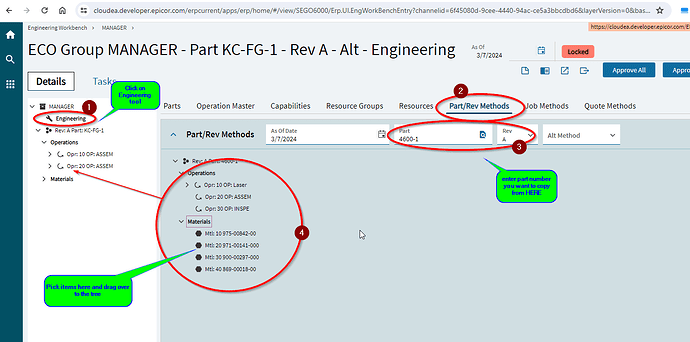

You can go into the engineering tool in the engineering workbench, and then go to the Part/Rev methods, and enter the part you want to merge… then simply drag over the components that you want to merge in.
Second option… merge the two into a JOB, and turn that job into a TEMPLATE job… then go into he engineering workbench and “get details” from the JOB instead of another bom.
Tim thank you im going to give that shot. havent tried that in E10 before but itll be nice if it works. If all else fails that job template method is easy enough for me so thanks for throwing both of those in here!
