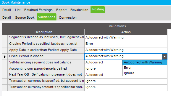

I think the system would complain that the period is closed. Apply Date is selected manually.
If I recall correctly, this is a setting on your Book Posting Validation Rules. The rule can be set to reject or just post to the next open fiscal period.

Do you know where the warning comes up? Is there a log file?

I don’t remember a message displayed during posting but I’ve never checked a log. If set to error, it goes to the Review Journal. We were surprised by an Auto-correct so it wasn’t obvious. This was 10.2.500…
