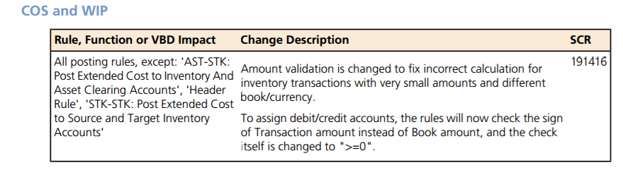

See if this matches what you’re seeing, Tricia. There’s a fix for this in 10.1.500.14:
You can download the new release information on EpicWeb.
Jonathon,
Thanks but I don’t think this matches. I stumbled across this problem as I was trying to reconcile Accounts Payable - mainly to make sure my Clearing account matched my Received not Invoiced report. This led to the discovery that the whole posting was such a different amount. I’ll cross that bridge later - right now my big concern is why AP Clearing doesn’t match the report - when it should.
Thanks again!
